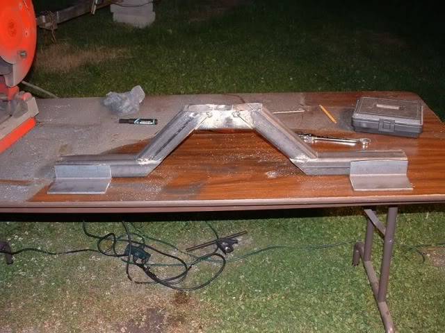

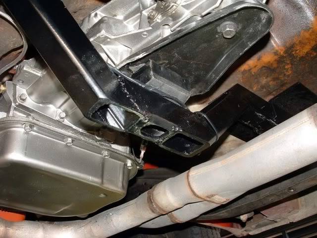

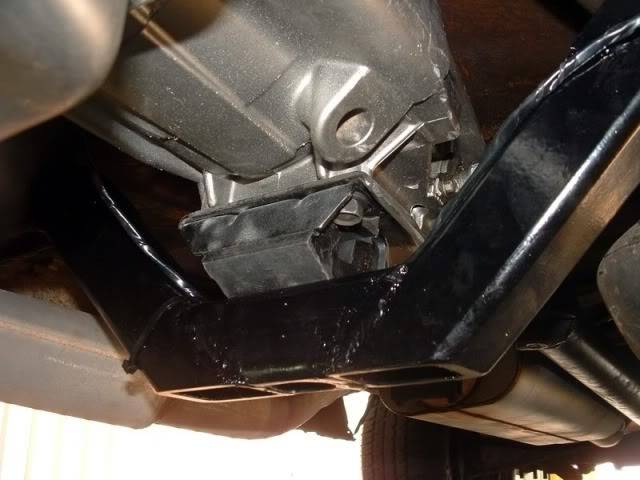

here are some pics that will allow you to mod the trans case so you do not have to mod your tunnel:
or this crossmember:

RaceDodge, can you tell me how much you dropped in height?
Looks like in one you dropped about 3" and about 3 1/2-4" on the other, is this correct and does this keep the angle on the driveshaft straight and true?
I have not done the swap, just saw it done, and have found pictures of it on the internet.
go to that link and it will give you ALL the information you will need. My only advisement on the trans crossmember location is to ensure you have the appropriate angle from your rear housing to ensure a good pinion angle.
Very good idea, now is the time I wish I could weld. But I have a very good idea of where to begin now and thanks everyone very much for your help.
