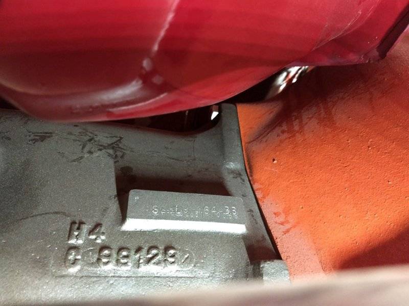

I have a 4 speed trans: 1969 GTX
Can someone tell me what is this casting #'s mean?
