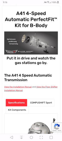

You might want to consider these folks. Don't have to cut the tunnel.

The Silver Sport 4L60E A41 kit is based on the old GM 700R4 automatic. It is a 4 speed with a deep 3.06 first gear with a .70 overdrive. I've driven cars with this transmission and it is a decent unit. Silver Sport supposedly modifies theirs to handle higher HP loads.

The Silver Sport A41 fits without cutting.
