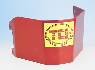

  • TCI SFI Cert. Flexplate Saftey Shield 727 Torqueflite tci-940200 $104.97 Summit Racing.jpg

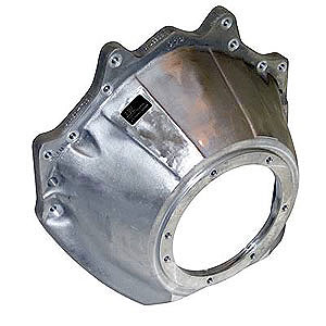

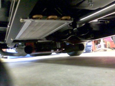

TCI fits well on mine. I did mod the right side slightly due to the fact the header almost touches the right trans pan rail. Blankets even easier but will hold fluid if you have leaks.
Doug

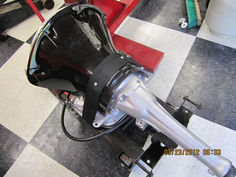

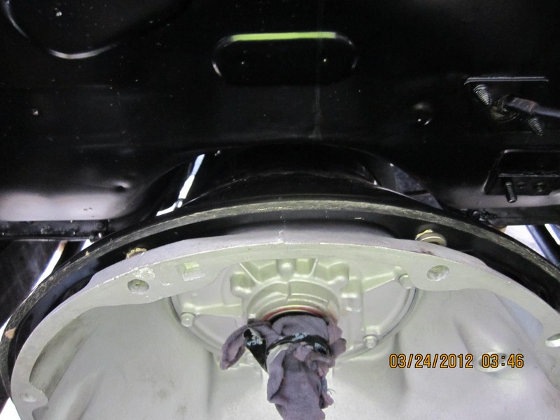

I went with the CSR on my '63.Tunnel needed some tweeking:icon_eek:

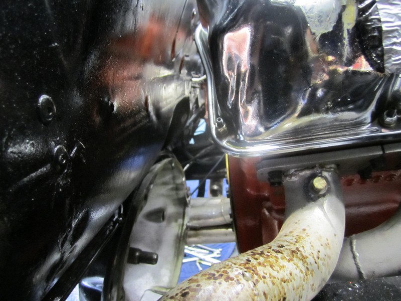

TCI will NOT fit a stock floor/trans tunnel!

I have an Ultrabell on another car. They are very nice!
The only strange part is cutting off the bell housing w/ a Sawzall but you get over it pretty quick.

That car with the TCI Safety Shield was basically a race car with license plates, it had a Capps Auto tubular K-member, front suspension & a custom trans cross-member, solid Moroso mounts on the engine, so the engine/trans were at slightly different positions, than what an all original factory set-up would be, but it cleared the tunnel with some minor hammer work in a couple of spots, {towards the rear of the shield/tunnel, if I remember correctly anyway} not sure how it would've fit, with all the stock mounts & K-member set-ups...
