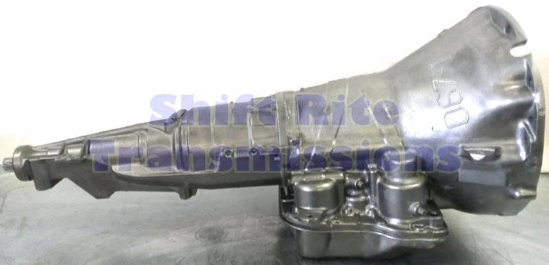

Isn't the 46RH the non electrical version of the A518 pretty sure the 46RE is electronically shifted and the RH is hydraulic is that correct? Below is the 46RH
46RH is hydraulic and 46RE is electric
I believe the 46RH can be found in early V8 Dakotas and dodge full size vans from the era. 86-96 maybe? I know my Dakota RT had a 46RE which mine was a 1999.

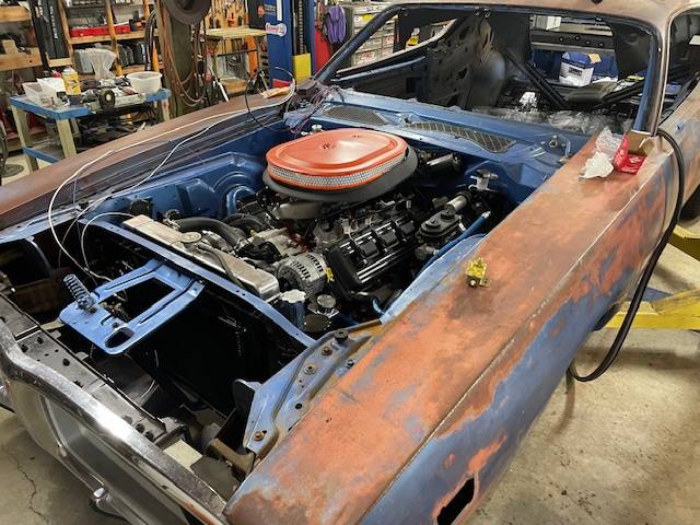

Great point in case here is that while building my 71 Charger with a 5.7 I decided I wanted to run a Mopar oval air cleaner which required a new intake, spacers, adapters etc. not to mention the very expensive air cleaner itself.
