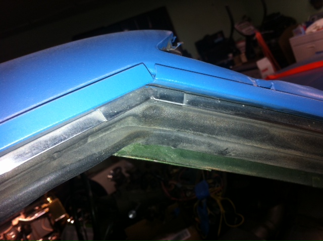

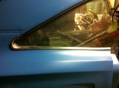

Hey again guys. My body/paint guy needs these trim pieces off and I am not sure the best way to remove them. Any tips greatly appreciated. Erik

The back lower corner should have a screw are a rivet in the center of it and on the top trim you have to pull the rubber seal out and there are screws holding it on. On the bottom piece on the back window I don't know my cARS didn't have that. You should be able to look at it and figure out how to remove it. Good Luck with it Ronnie
That bottom piece on the back window is held in by screws on the inside. This is how mine came out. You have to first remove the inside panel to get access inside. You then have to remove the window stop at the bottom of the glass so the window will roll down all the way (otherwise window stays up too high and blocks access to the screws). Then you have to remove the felt/rubber window seal(push up, held in by clips). After that is out you will see and have access to the screws holding that chrome trim.
