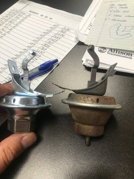

mine went out on my car and everyone ive ordered is backwards any help is appreciated. pt no for the new one in this pic is CV3031 69 440
OK, get ready for a stupid question (seriously, I don't know)....Can that vacuum advance arm be turned over 180-degrees????

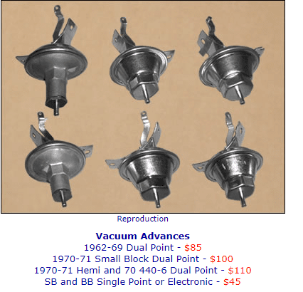

Okay, my question time, is the left for a small block and right for big block?
The one pictured on the left look like a 6 cylinder VA
The right is definitely for a big block. Also, how much vacuum is your engine making? If it's low from a big cam, you can get a custom can from Don at FBO to engage at 5inMg. If not, Tony's parts has the stock ones on hand. Better than any parts store will get you as far as correctness and something that will work correctly.
