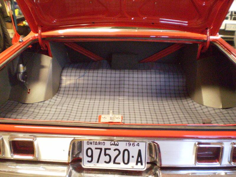

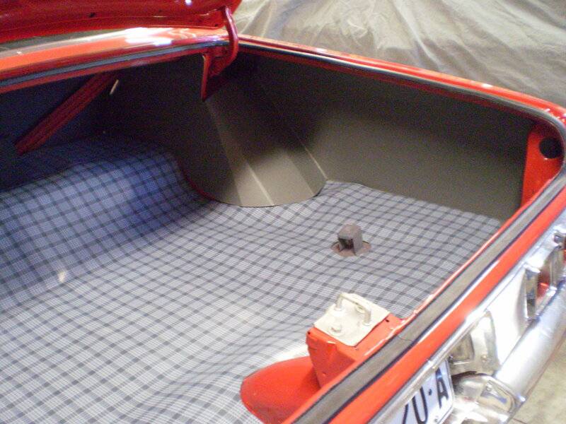

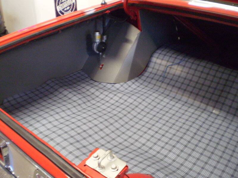

If anybody is interested in tidying up their trunk compartment, Classic Industries has repro trunk side panel boards available for 1962 and 1963 B-bodies. I bought a set of 1963 hardtop panels for my 1964 Polara. There is a certain amount of bending and folding, but they dropped right in and look pretty good. Part #'s MB437 to MB443, depending on application. I imagine, with minor trimming, they will work for '64 and '65 B-bodies as well. I have posted pictures of install in my car. Note that all Canadian Dodges and Plymouths mounted spare tire like US convertibles.

My car did not originally have these. I have old period drive tests by Motor Trend, Car Life, etc. showing these in 1962 and 1963 cars, but I don't think they were offered for 1964. Since the '63 and '64 trunk areas are almost the same, I decided to use them anyway for a tidier appearance.
Right, I think that only the outer trunk drop off pieces were present in 64. And of course they are reproduced.

Mine has a J-hook that passes through holes on sides of bumper hook and threads into trunk floor bracket to hold spare wheel and tire in place. Note that this is Canadian car, and U. S. may be different.

No, it was just the boards. My car had sheetmetal tabs under the trunk drip rail from which the boards hung ( the boards were punched for this ). You will need to come up with a pair of button-headed spring clips like the ones that hold the rear package tray in place. I saw the clips that another poster showed, but my 1964 Polara did not have these.
To add to the confusion, my 64 polara 2dr hdtp  did come with the panels. Canadian car.
