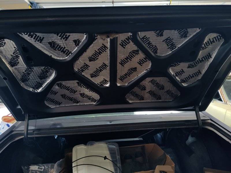

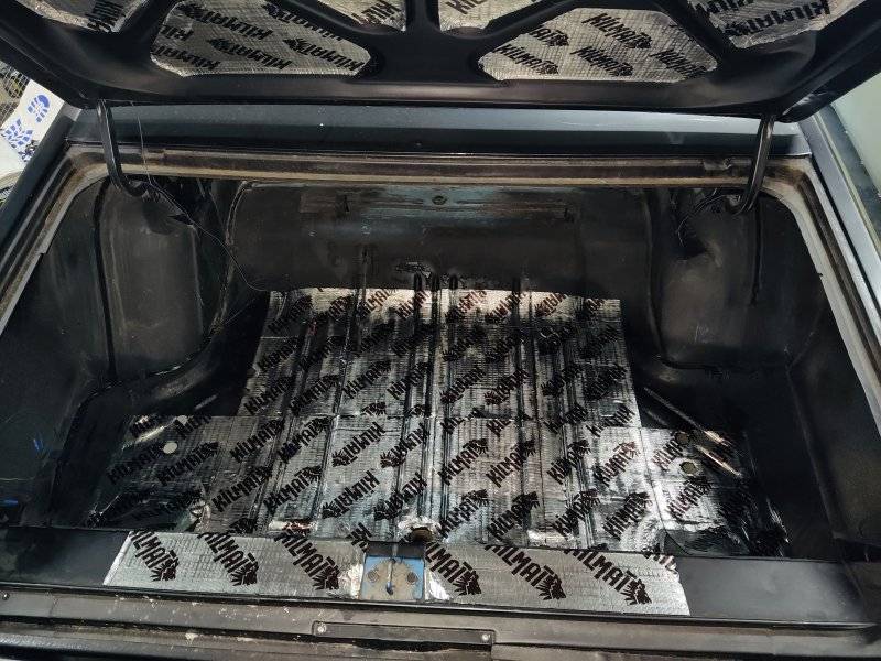

1971 Plymouth Satellite. I'm going down the rabbit hole that is sound reduction. I'm using kilmat in the trunk floor and trunk lid. My question is about the trunk divider panel.

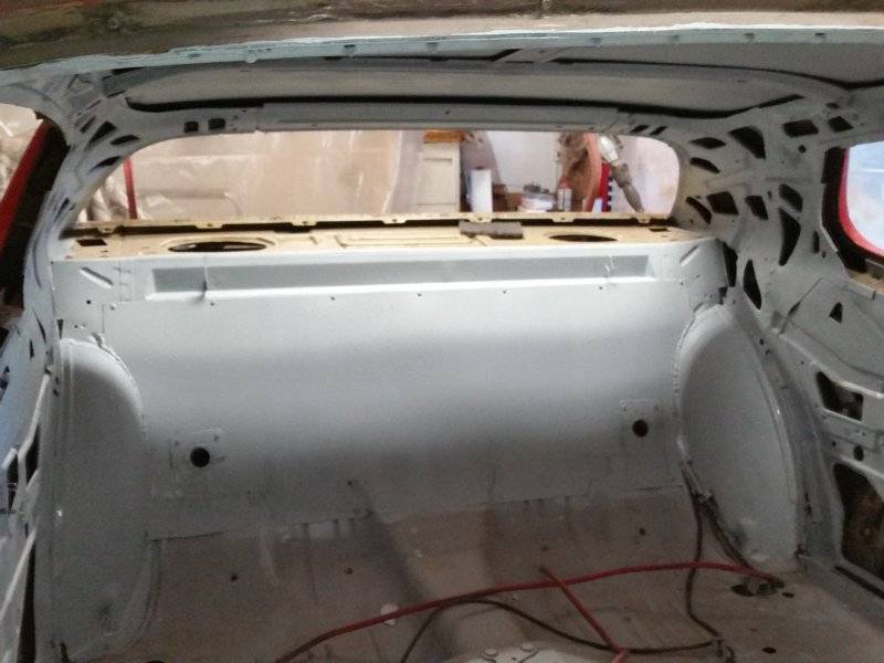

My 71 was a drag car in it's previous life.
It still had the tin divider in the car when I bought it.
I kept it in the car as I kept the battery in the trunk.
Here's the divider.

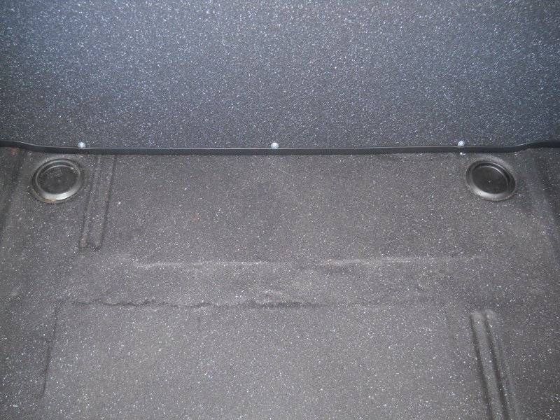

I covered it with Dynamat.
