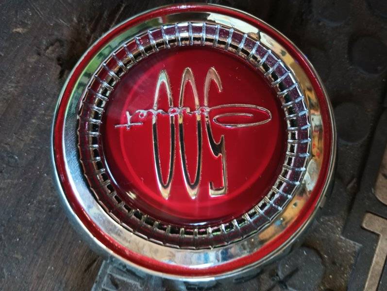

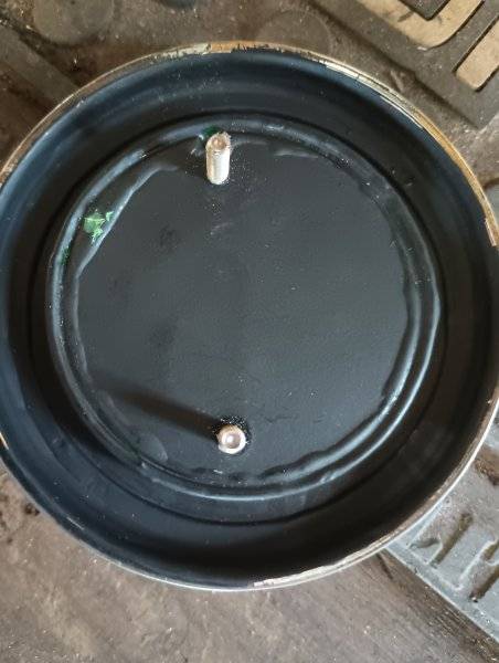

The trunk emblem for my 65 Coronet was restored years? ago and had been in the box. When pulling it out I see it where the chrome on the ring has cracked in several places. Does anyone have one apart where I can see how to remove medallion. Looks like it has been epoxied.
Thanks for the help

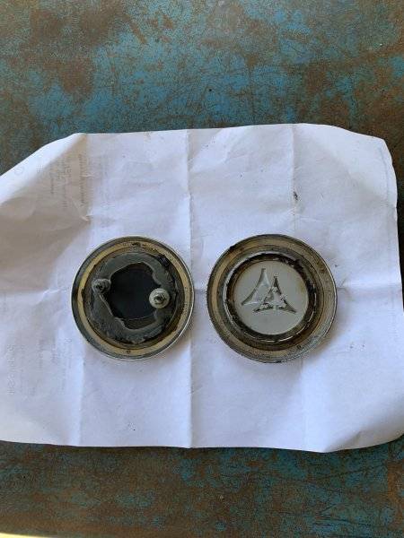

I have two I can dig out of the storage totes I have them in this weekend when I get back to my shop.
Unless some one can step up sooner
Ed

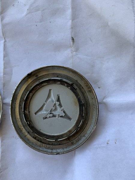

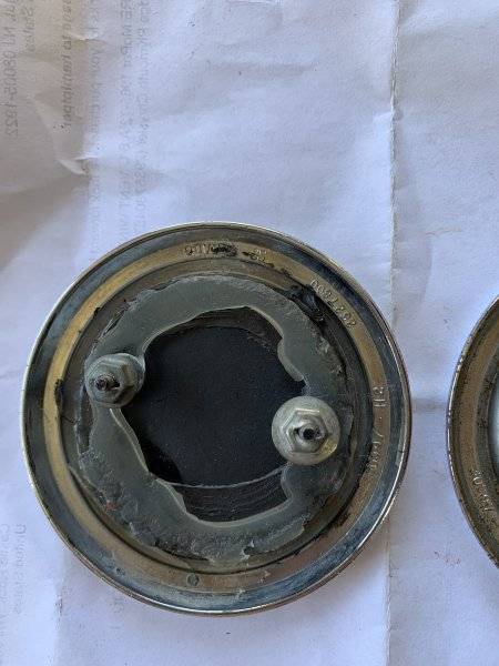

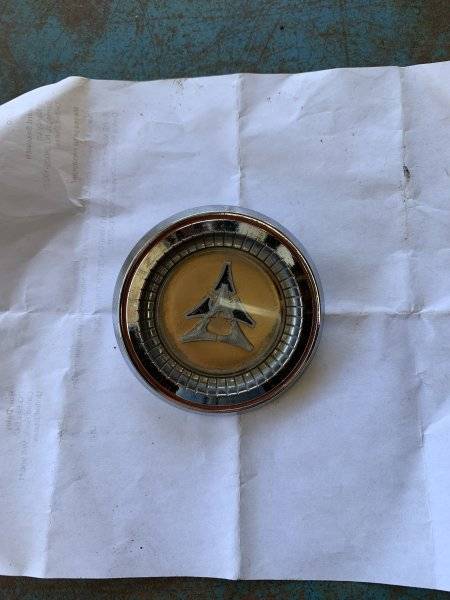

My emblems are both 440 emblems.
Looks like the mounting plate is a common issue, or at least with mine.
One emblem has the mounting plate siliconed in and the other is missing. but you can see grooves in the bezel back.
Looks like they snap together or lock together.
Ed
