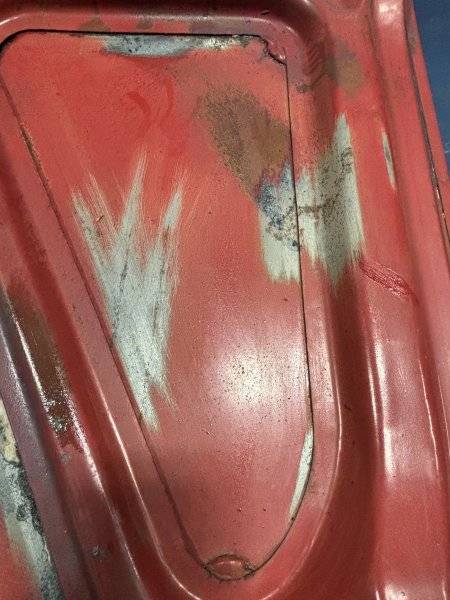

Hey there I’ve got a trunk lid for another Mopar that is separating from its inner structure. Should I just tack weld it back together or use some body glue or something similar to factory?
That is not separating, it looks factory like that. They used daubs of putty so it wouldn't make any noise. Do not weld that.
