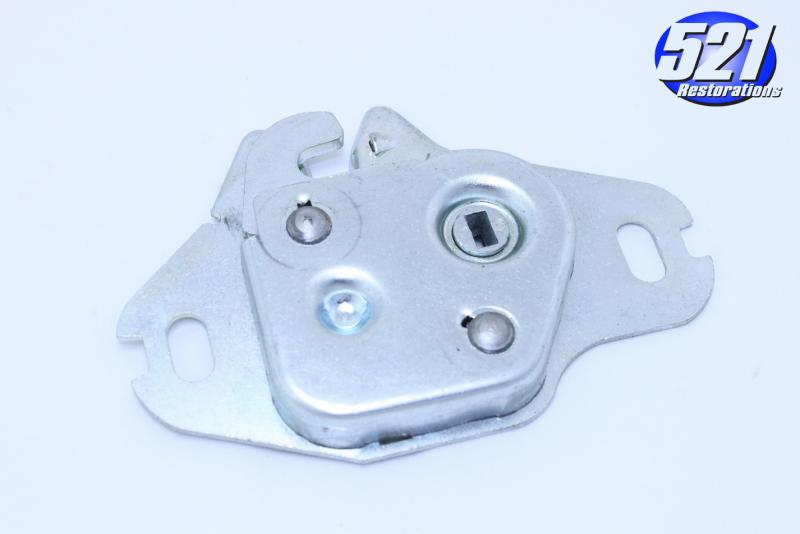

69 Dodge Charger, trunk will not open. Key turns but will not release. I removed the back seat. Is there any way to release it from the back side? Any help would be great. Thanks
Sure (assuming it's like my '68 Fastback Cuda anyway lol). Climb into the area behind the top of the back seat, taking a drop light and flat screwdriver with you. On the back of the lock you'll see a little slot; put the screwdriver in it and turn it a little. It'll pop the trunk open.
If that doesn't work you could also simply remove the trunk latch mechanism. There are two bolts or screws holding it on. Here is a picture.
Oh sweet! There's that slot I was talking about earlier. Great pic!!! Thanks for the backup kb :D < hug >

if it is a tight fit to crawl in,then duckt tape a screw driver to a broom stick to reach it.
Open now. Thanks for all the help. Had to go in the trunk and unbolt the latch. Seems to be all gummed up.
They do get that way Jay, but a few little PB Blaster or WD-40 squirts in those little holes you can see up there in kb's pic (next to the rivets) combined with working the latch open and closed a few times should free it up. Sometimes it also takes a couple light whacks with your BFH but usually the lube is enough.

Incidently, I stole that pic from eBay. That's a repop latch assy that goes for about $55. I would definitely try the WD-40 method first.
