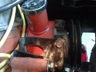

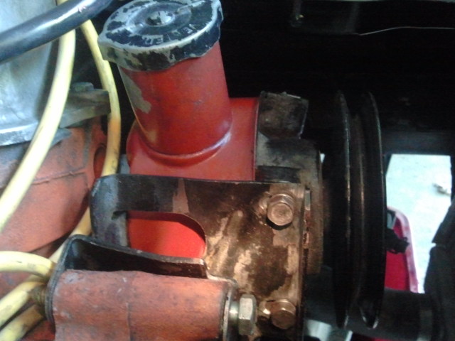

I just came back in from working on it. I have it set now. If you look at the picture you can see two of the mounting bolts
that connect the pump to the bracket. What I did was expand the holes in the bracket wider so that the pump could slide forward some in the hole. I then shimmed the back bolt to make up for the movement forward. All looks good now. Maybe someday I will get the correct Saginaw pump for it.
