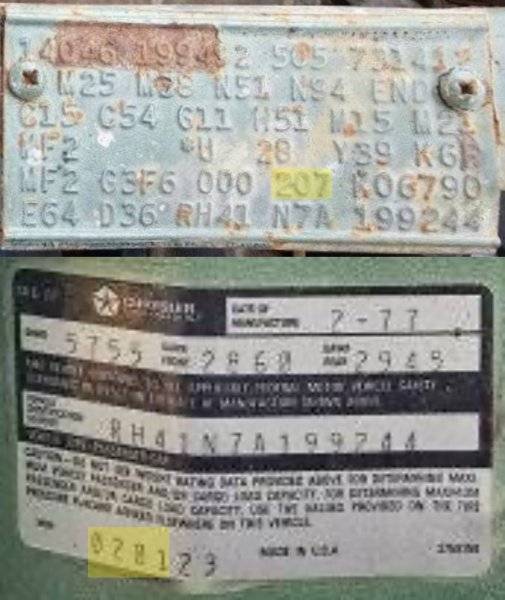

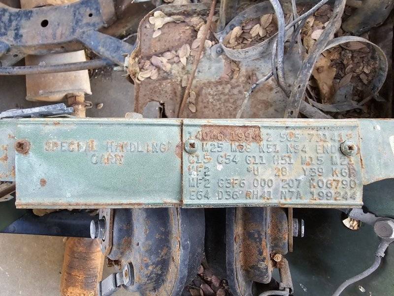

Trying to decode this radiator support tag on a 77 fury salon

So I've got a 77 plymouth fury salon with matching 400 block and tranny that's apparently an ex sheriffs car according to my grandad and ive de-coded the VIN however these tags are throwing me for a loop, can someone point me in the right direction or help me decode this sucker! Thank you!

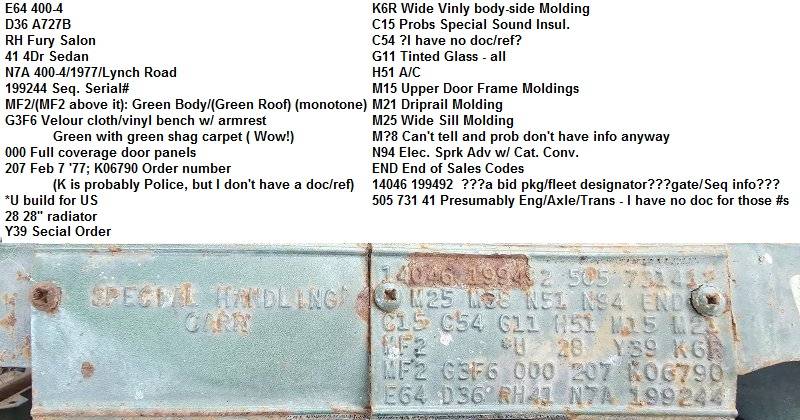

This car is pretty "new" for whatever documentation I have, but always enjoy a challenge. Hopefully someone else can add in for corrections or missing stuff.

199244 - 99,244TH VIN assigned. Unrelated to production or anything 'sequential' other than following 99,243 and preceding 99,245.
K VON is consistent with Y39 Special Order coding. While many 'cop cars' have K VONs, other fleet non 'cop cars' have K VONs also.
C15 - sound deadening package 1
C54 = Split back bench seat with center arm rest.
M?8 = likely M38 indicating deck ornamentation
The top row is typical of Lynch Road tags listing the GATE BASE and SEQUENCE numbers related to producing the body ion white while the remaining codes are the three digit ENGINE, AXLE, and TRANSMISSION assembly codes.
It was a special order car but there is no way to know the actual application or intended use. Even for a 'detective' car, this would be pretty upscale car for a county Sheriff office with tight budgets. Upscaling the car does not increase the effect of the intended use. Fancy seats don't solve more crimes and costs the taxpayers more.

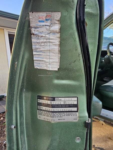

Ongoing documentation that cars were built before and after the Scheduled date.
The SPD is not a 'build date', 'birthdate' or any other date necessarily related to actual production. It's simply an administrative 'scheduled' date.
I didn't know that! That's cool so it would've been built sometime around that time?
Not sometime. The door sticker was one of the last things put on the car upon assembly completion. So think of the door sticker as the the 'out the door' date. It's a hard date for production documentation. For this car, it is 0201 or February 1st or six days ahead of the 207 scheduled date. The door sticker date is related to actual production. The tag date is not.
