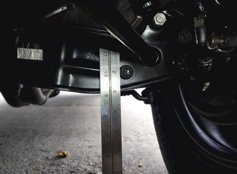

The fsm for '70 charger on page2-4, step 3 states to measure from lowest point of one adjusting BLADE to the floor (measurement A). The picture shows a cut-away view of the LCA. I'm not understanding what that is. Secondly, the manual does not mention loosening the bolts to the LCA or jacking up the car to get the weight off the suspension as some have mentioned in the threads that I have read. I have recently replaced all the usual parts when rebuilding the front suspension and torqued everything to spec. while the car was supporting its weight. Would appreciate clarity on these steps. Thanks
I like to take the weight off of the adjusters and also measure from the frame and not the body.....
When setting the height I measured from the floor to the low point on the LCA. It's 9" in this pic. Make both sides the same.
