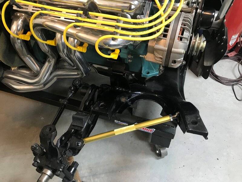

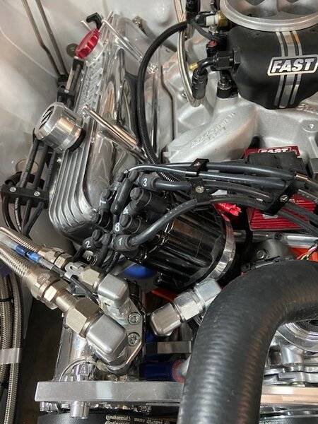

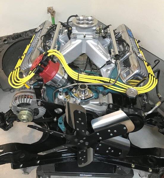

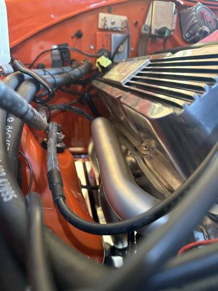

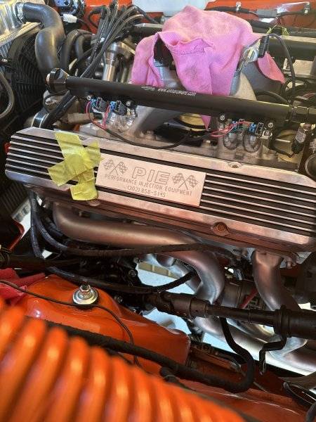

I use a combo of 90’s and straights. Usually buy a set of each. Not a big fan of **** hooked to the valve covers with a solid cam.
2 inch TTI, with Accel Ceramic, used straight, 90 and 45 degree.

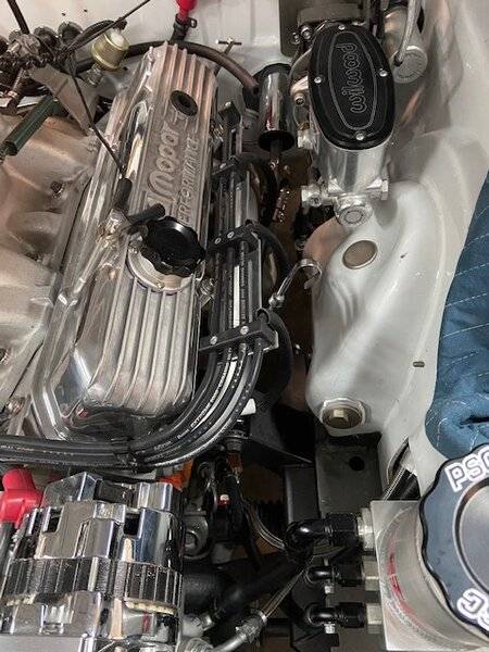

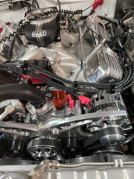

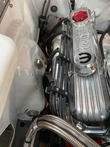

2" tti headers. I use 1968 factory wire looms. Everything tucked in and no burn problems.
Hi mate

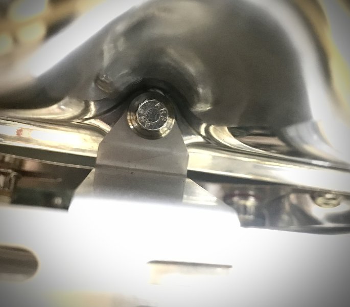

Where did you get your loom bracket? And how did you raise it up as the tti header goes above the rocker cover flange?
I fabricated some Z brackets out of some 20 Ga. SS and attach to the lower VC bolts. Welded some studs on the top flange for some thumb nuts to attach the looms (those black pieces with a knurled head). Works great, keeps the wires away from all that heat and a snap to remove for cleaning, plug changes, etc.
