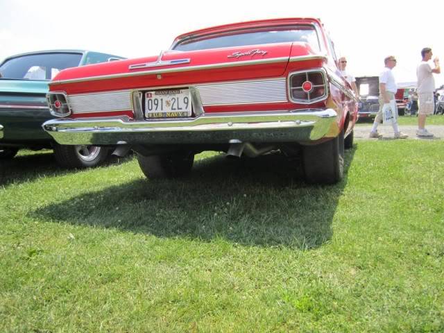

69 coronet hemi

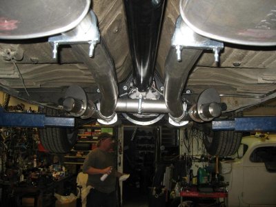

IMVHO; headers are not fun,
tight fit...but TTI are the right fit!...:eusa_think:
.instant power. once you install

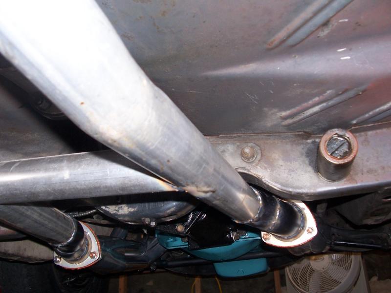

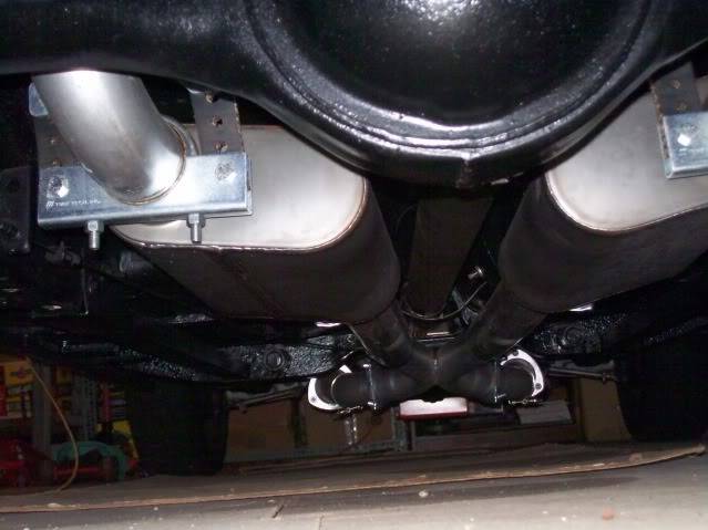

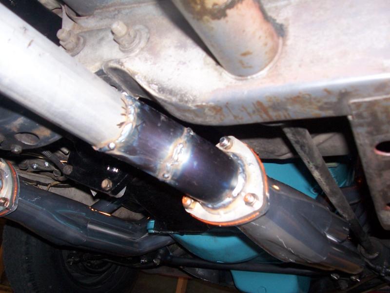

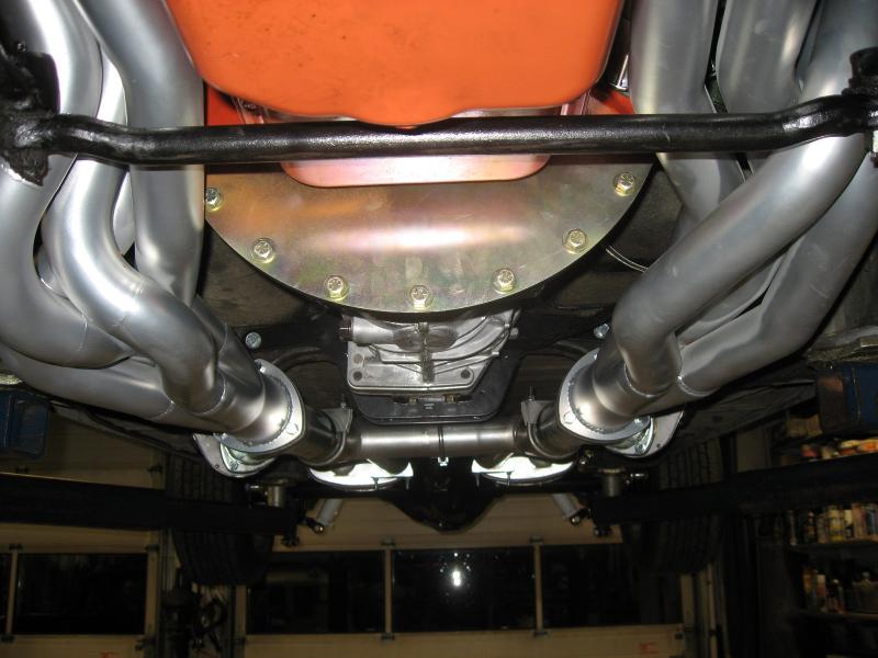

I too have the TTI's, front to back--3-1/2" collectors to 3" X-pipe exhaust. One slight complaint: Though the headers work beautifully and fit like a glove, the mini-starter is a must (the headers won't fit using the stock starter on a big block--don't know about a 318) and the resulting clearance is only about 1/2" from the nearest tube to the bottom of the starter. When you stop the engine, the heat from the header soaks the starter and eventually will destroy the windings. I finally wrapped the mini-starter with a heat shield and the horizontal portion of the header tubes with DEI header wrap to solve the problem (after these pic's were taken). TTI denies getting complaints about this, though I know others have contacted them.
Good Luck;
Bob

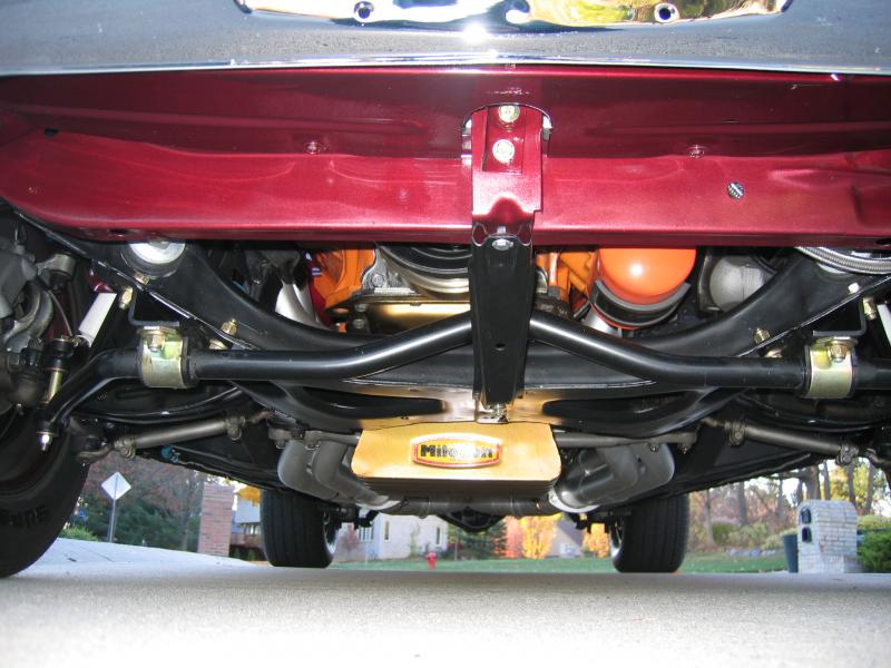

I also use TTI. 2" TTI headers with 3" X-pipe system out to rear bumber. Ron
