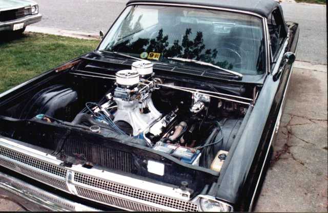

Personally, I highly recommend Vacuum secondary carbs. Keep them small if you can. It helps a WHOLE lot if you have a taller gear 3.55 and up. I have two 750 Holley carbs, vacuum secondary, on a 440 with a 3000 rpm stall and 3.91 gears. I drove this daily for years (when I was younger). It was a blast to drive. I was pleasantly surprised at how well it ran on the street. You will need to play around with the accelerator pumps (both squirters and cams) to get throttle response where you like it. It is doable. I ran without a hood for a while and finally cut the hole after two years of constantly cleaning things on the engine. Biggest trouble I had was that the air filters would have to be replaced when they got wet (I drove around with spares).
