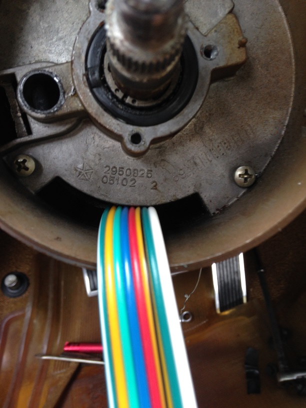

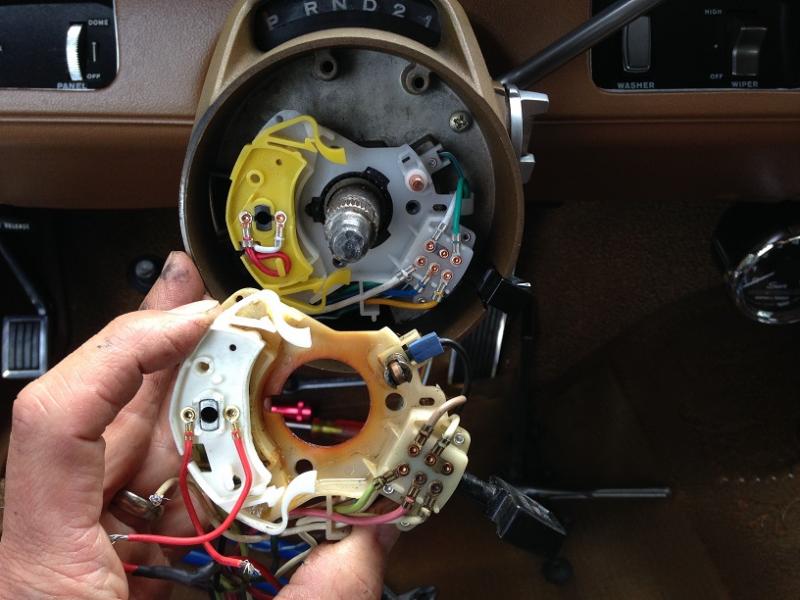

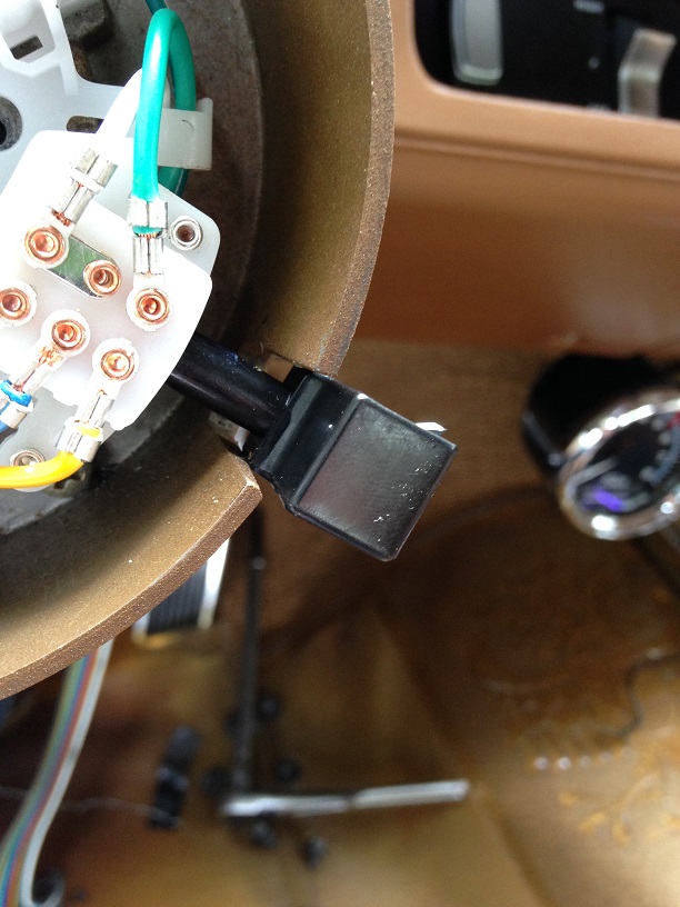

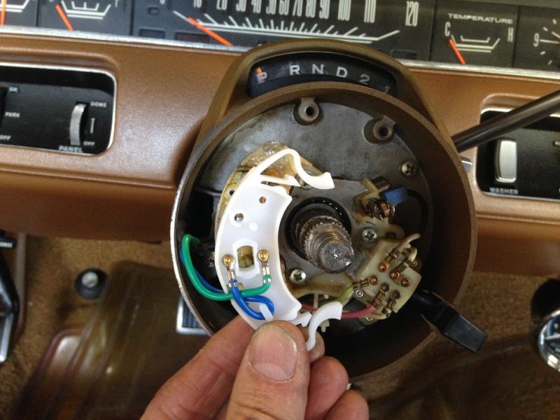

Do you mean the fingers or the circular contacts? I checked everything over a dozend times and visually there seems to be no issue. I am afraid to cause more damage by taking the entire switch apart.....Will look at everything again and report back. IMG_0592.jpgIMG_0593.jpg

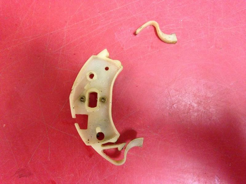

Then your cam probably looks like this. I decided to replace the whole switch with the cam already pre-installed. I will update once installed.IMG_0715.jpg

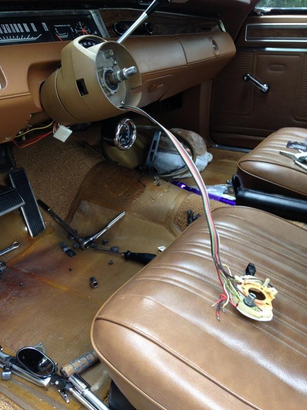

Well, I decided to take the advice of A383Wing and go with a whole new switch. It arrived yesterday and I plugged it in (outside of the column). Now I need to figure out how to feed it down the steering column for final installation.....hopefully tomorrow.
run a stiff wire like a coat hanger up the column where the wires come through....then tape the turn signal wires to the coat hanger wire and pull the turn signal wires down through the column
That's exactly what I did. It was the most difficult part too.

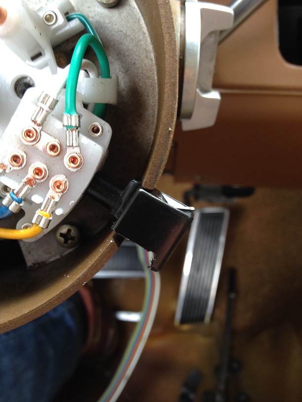

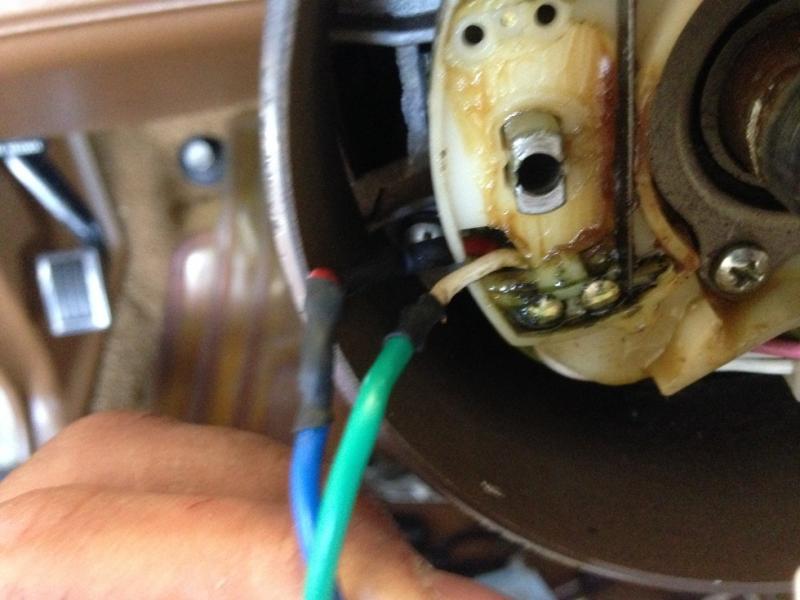

Then connect the wire to the new switch and fish everything to the small slot you see here.IMG_0780.JPG

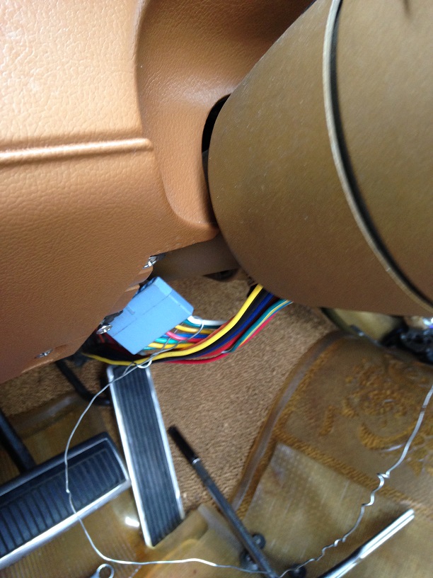

One problem I had was the fact that the hazard switch was too big although I was told it fits B Bodies (online part number SM111).IMG_0781.JPG

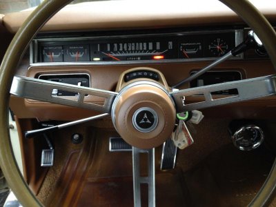

And finally everything put back together and going for a test drive. yeaaahhhh !!!IMG_0786.jpg
Yes. Just like new. Everything's tight.I didn't want to tackle the whole switch but I am glad I did.
