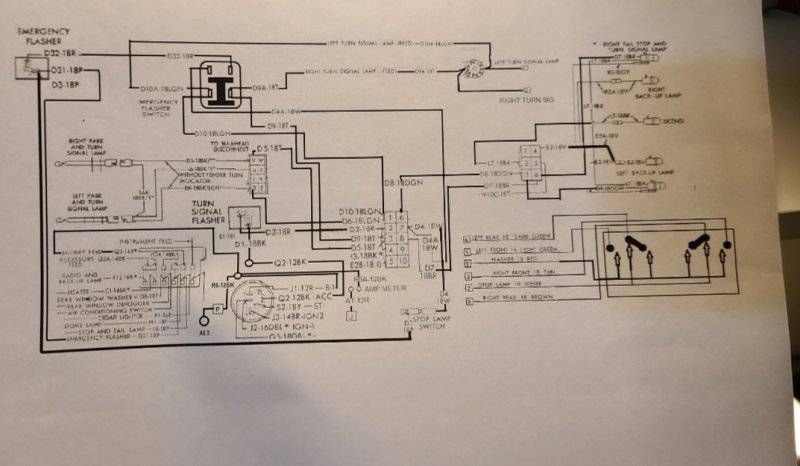

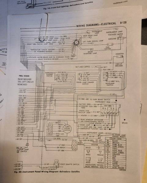

I like to clean prints up and make simplified turn signal prints showing the inner workings of the switches.
The factory prints include things like lift gates and rear accessories.
Make it confusing.
These are for a 69 B body and I would assume a 70 isn't different as far as functions.
The importance is that I'm thinking the turn signal is separated from lighting except by the parking and stop lights. Correct?
