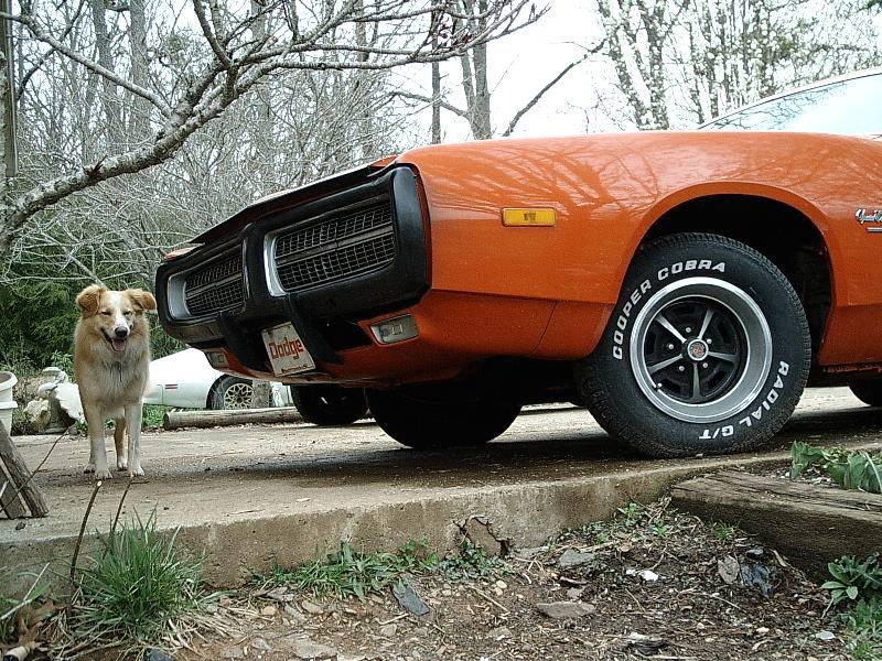

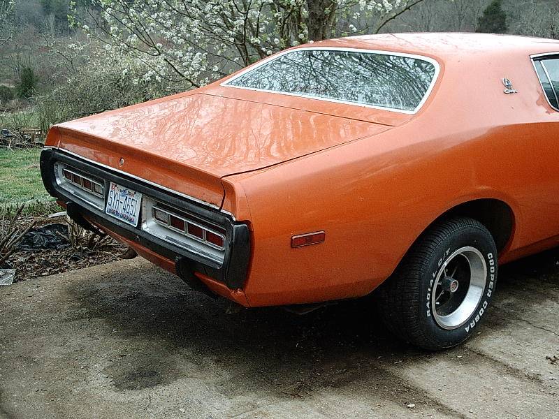

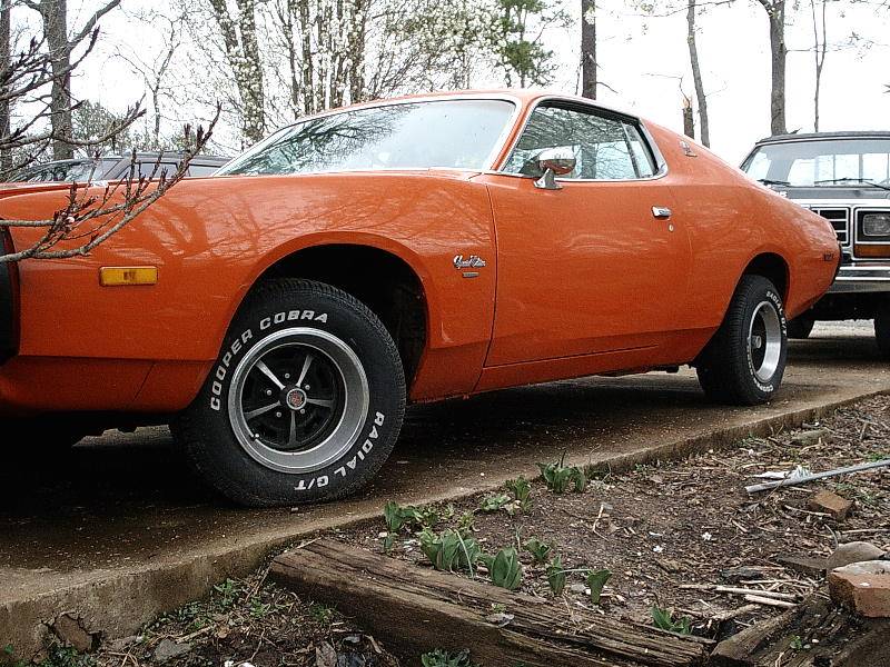

I have the sales sheet from the dealer that sold it as a spring special near Pendleton NC. Have the broadcast sheet, the engine and transmission are #'s matching. A GI bought it and he brought corn liquor, white(sugar) liquor, apple brandy, and he brought Stroh's by the case there at Fort Jackson SC. Someone who remembered the car contacted me on now obsolete but barely operational Mopar forum- I know he wasn't lying because he had pictures of the car filled with liquor on Fort Jackson and he knew the name and rank at discharge of the original owner. This attached is a 2 owner car. I have replaced the HiJackers on it in these pictures- I wish I could still get a couple extra sets.
I'm not lazy, I'm glutton for punishment, and I'm stupid- but before I did what you are contemplating, I would just buy a base model WM21 WL23 or WM or WH so long as it is a 21 or 23 over a WP29 and then double what you have in the WP29 trying to convert the window plug. You would end up with $12k-$15k in car you could pickup for $3000-$8000 already as you want.
If you want the hideaways, just buy a bumper and the hideaways and add it to a base.

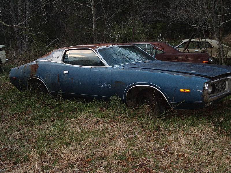

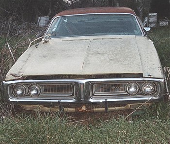

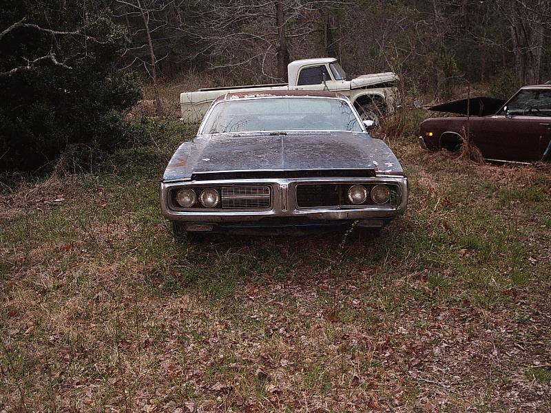

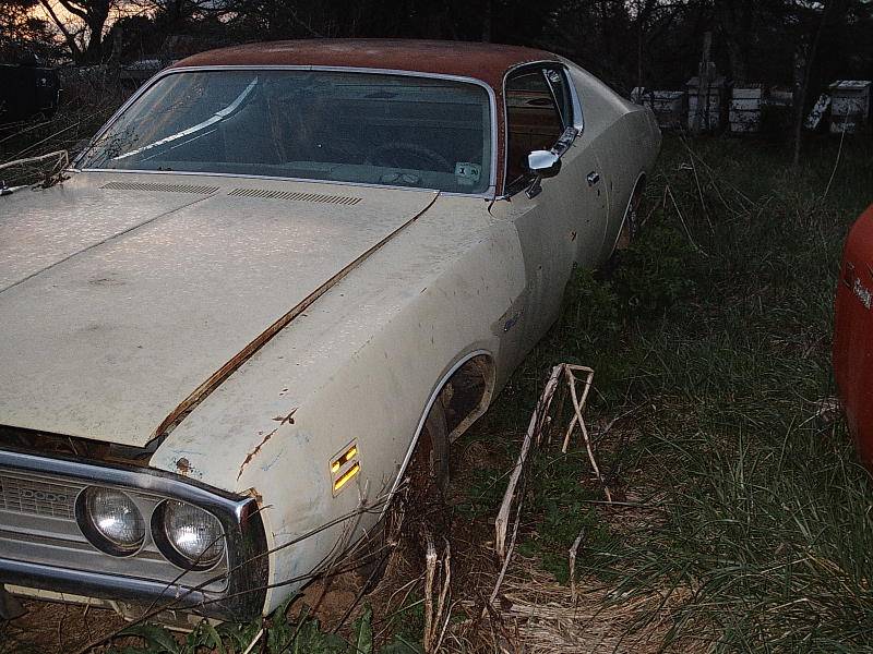

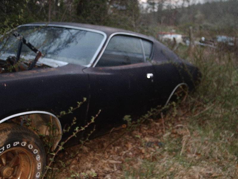

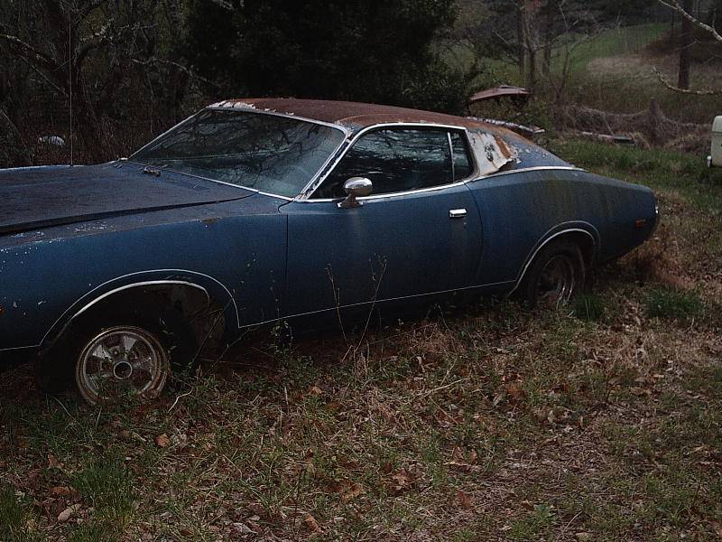

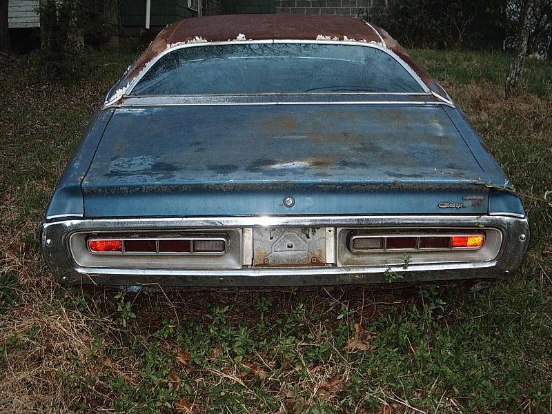

These are just a couple of the 71 and 72 Chargers I bought- this where they were...
