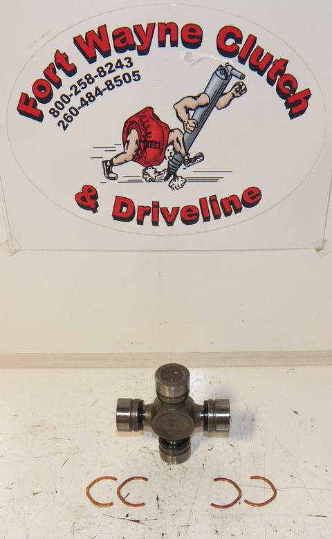

This u-joint is in between your u-joint and the one I posted earlier. the grease fitting is in the end of cup. It is much better than your u-joint and grease able, need a special tip for your grease gun.
