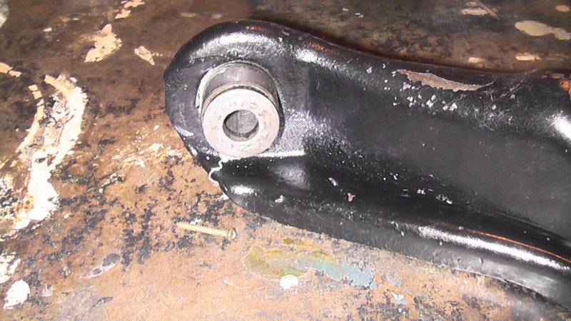

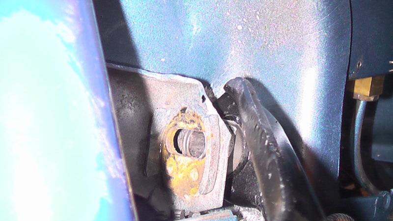

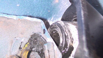

I have noise in the uca bushing i think it missing that washer that has nibs to bit have a look at that bushing what you think.
You referring to the eccentric ? That's how you adjust the alignment.

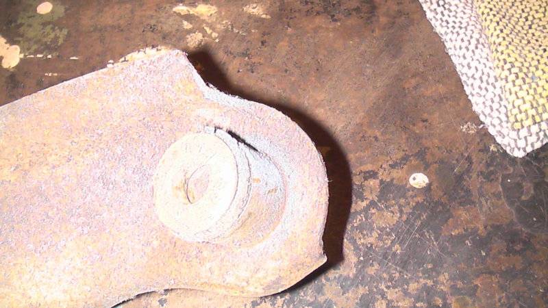

this is off my old 69 dart not the arm i am working on as you can see the end of the bushing has that washer with the bumps around it,mine is missing that.right.
here is what i am talking about the end of the bushing is missing that washer with the barbs around it right.
Looks like you're missing the metal insert that goes inside of the bushing....it's also made with that washer you are talking about. The insert and washer are one piece. The insert is maybe 3/8ths to 1/2" long and there is one on each side of the rubber. They mount on the bolt.....

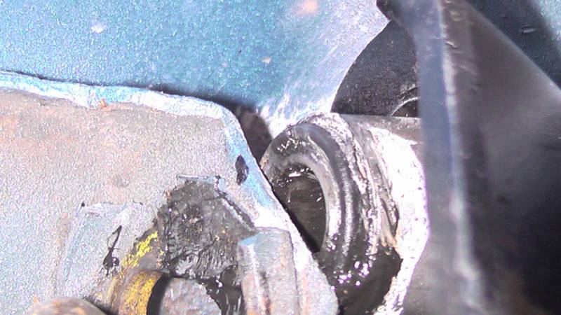

Thanks like i said before i had a stroke 5 years back,i need to give up on this hobby,that why it was makes noise,had an alignment just Thursday what a waitse of money.
My a-body has a c'bore for the end to fit in. Are B's different?
And, found your noise!
If it helps, once you get new bushing in the arm, when you install the nuts/bolts, do not tighten them, until the weight of the car is on the wheels. Like that, you don't put the bushing itself, in a bind.

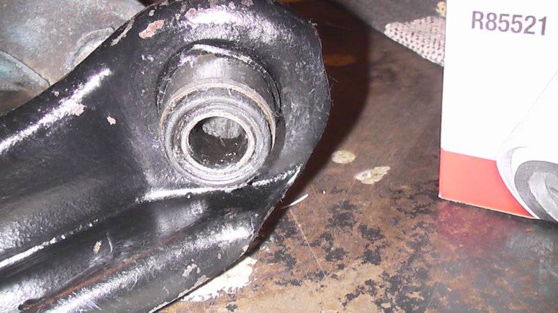

Yes I feel better,i don't know how i missed that very in-portent part,don't let me work on you car ever. the prof is in that pic.
Any tips on sliding that arm back in,from what i remember last time it was a tight fit 1 would think it would slide in with little effort.waiting for the bushing to come in than back in it goes .
Don, after I installed my new bushings I used a rubber mallot to help get in place. It is a tight fit.
Got the bushing in at 930 and all is back together NO NOISE WA WHO.I can tell ya will not make that mistake again.
