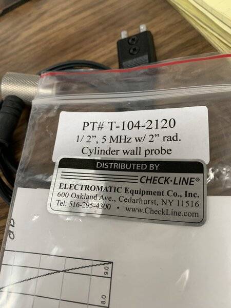

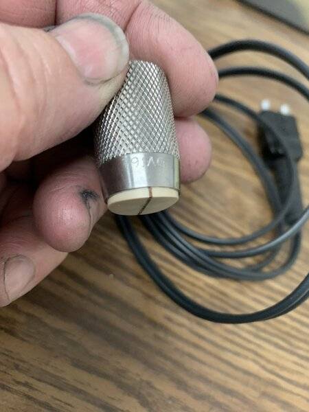

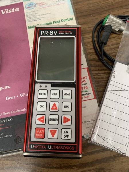

Anyone recommend a good sonic tester for cylinder wall thickness measurements?

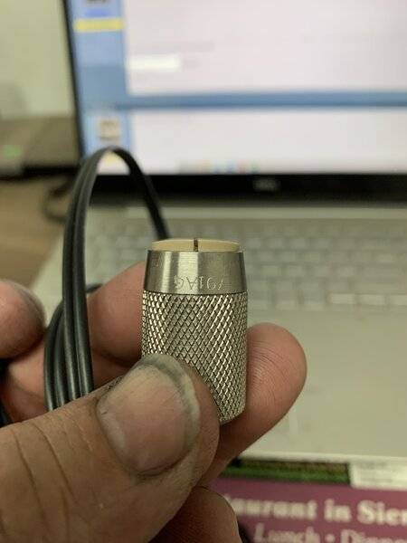

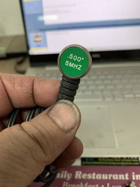

I’ve been researching online and all of the probes i see are flat faced do these work with the radius of the cylinder?
Could you give me some info on which part# transducer you have?
