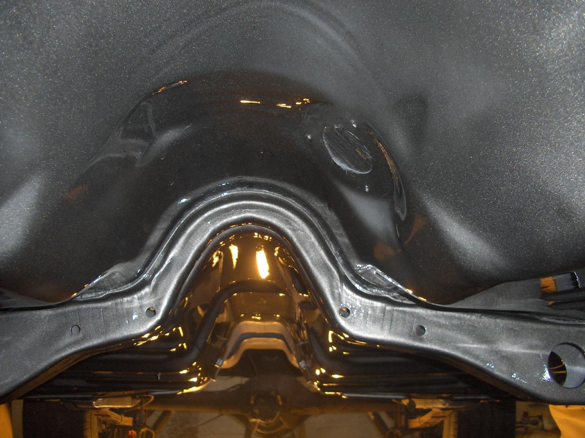

I used the bed-liner in the spray cans inside the trunk area looks good and so far holding up very well. im think im going to use it on the floor inside.
I just did mine,I sanded it down, hit it with rust converter then scuffed it then used 2k primer and then just painted it.My bud did his the same way 5 years ago and it's still in good shape.
