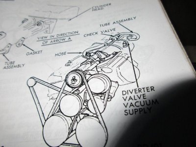

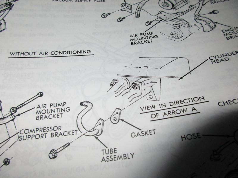

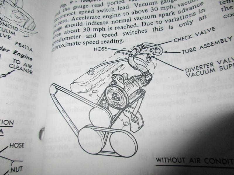

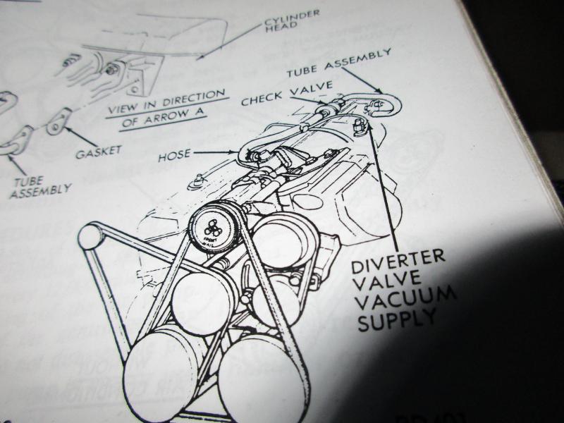

It might be the California Air injection, do you have any pictures of what they look like or where they run to?

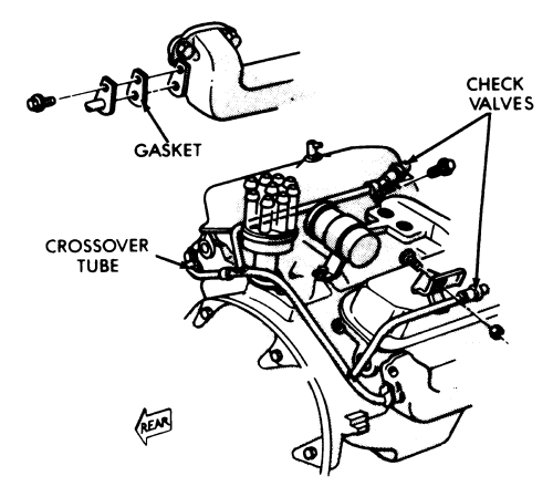

Not finding much for small block air injection systems in ’73, this image appears to be late eighties small block and varies slightly from your description. May want to verify casting numbers/dates on the manifolds and block to determine engine or manifold model years. If the driver’s side dos not have the same casting/fitting, one of them has been replaced, may be wrong application somewhere. The FSM should have details on the Air Injection system for the year of the motor. Air pumps started in ’72 on big blocks for California production only. Not sure of the specifics for small blocks. Would be looking for a non-air injection manifold however, the internal pluming is restrictive if not running an air pump.

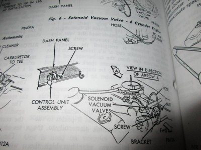

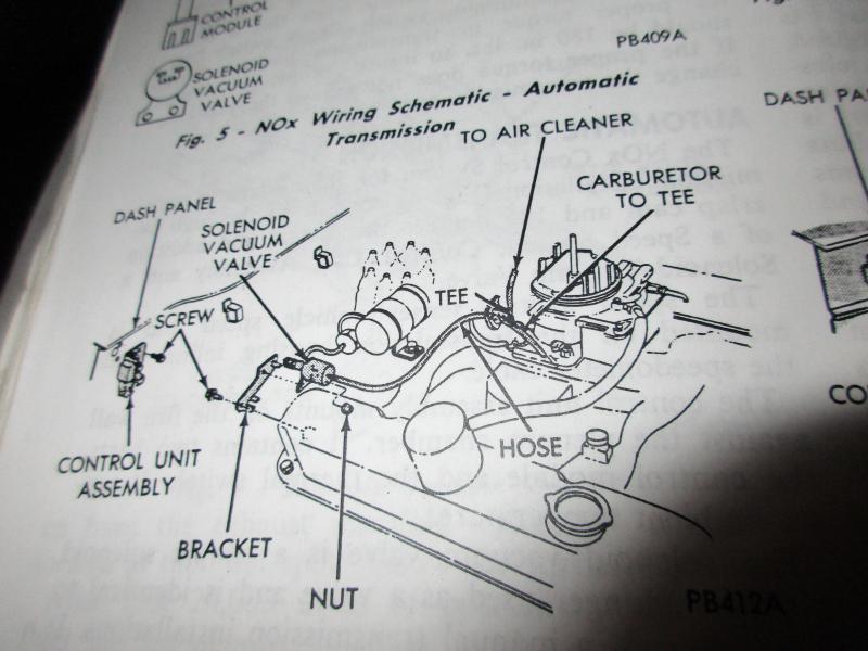

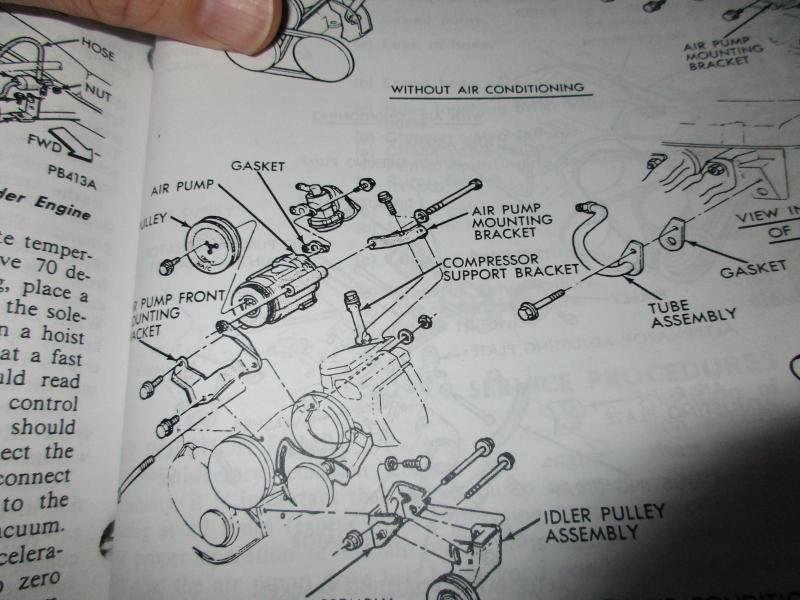

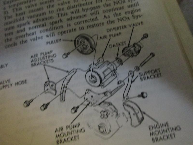

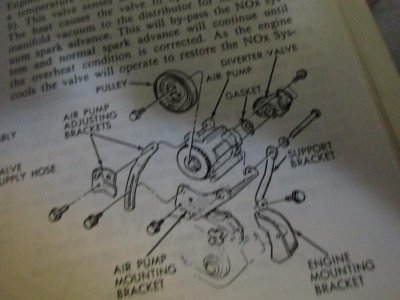

This might help
There's no air pump on it unless I'm just completely blind lol. It does have a vacuum amplifier on it as well if that helps ID it as a California model or anything.
