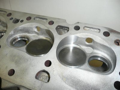

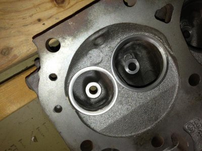

Although these are Chevy heads, you can see the seat for the exhaust. You should be able to see the smooth silver ring around the outside dimension of the exhaust valve. The second pic is a Mopar head with both intake and exhaust seats replaced.

Yup, that's what my 906 heads looked like when I had hardened seats installed way back in 1990.

Won't have the ring/insert as pictured, and may lose their hardening from the heat and material loss from doing a valve job.

No BB head had a non-removable seat unless there is some weird industrial head I have never seen, and you can't really tell by looking if it's a stock seat, or replacement, unless it's a huge aftermarket seat like the ones that are pictured above (most replacement seats are not nearly that big a diameter).

I do not understand this comment "No BB head had a non-removable seat unless there is some weird industrial head I have never seen, and you can't really tell by looking if it's a stock seat, or replacement, unless it's a huge aftermarket seat like the ones that are pictured above (most replacement seats are not nearly that big a diameter)." No cast Iron head that I have seen has ever come from the factory with a replaceable seat, and these seats are nowhere close to being "Huge". These are stock size replacement seats on both sets of heads.
