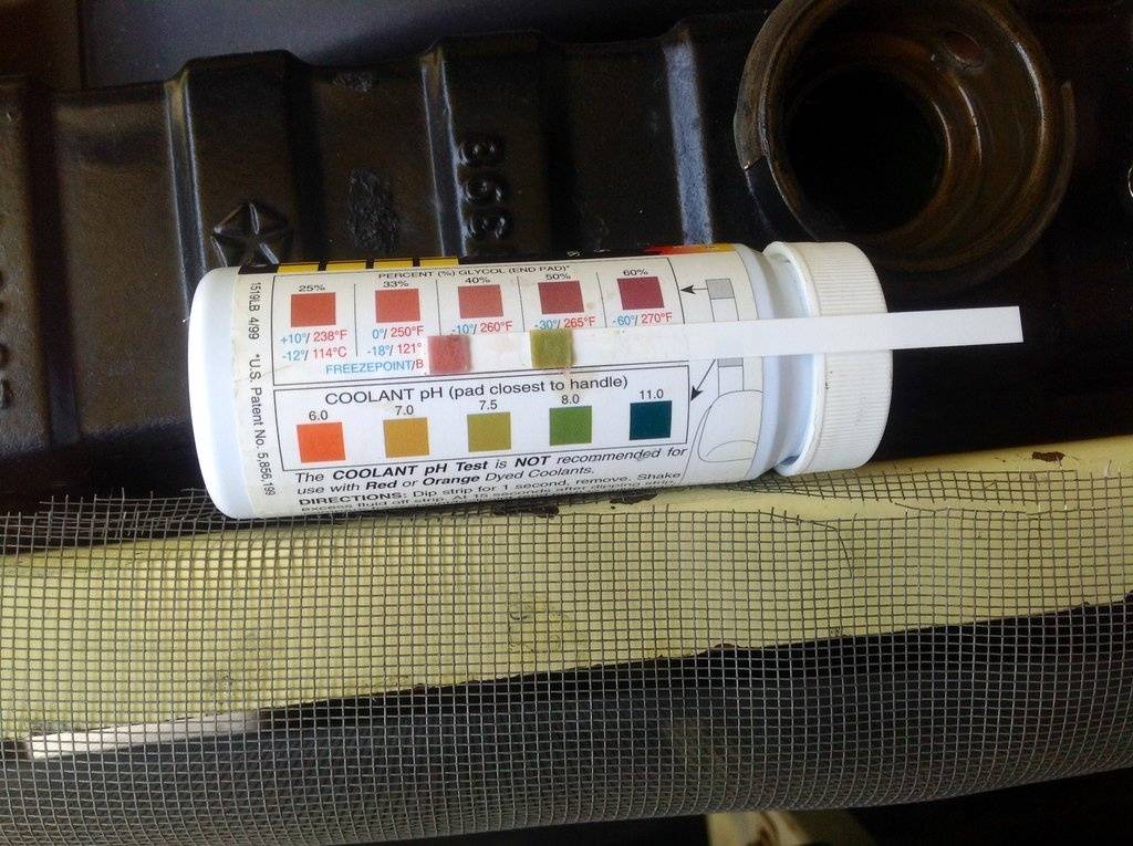

Besides the year of my car, 65, and lots of added on/changed wiring over the years, my main wiring redo requirement wast that its going to be efi. Don't need to be having electrical issues that may take out expensive items. And on the switches, I had read some posts by a guy that had been chasing an electrolysis issue in the cooling system that took out two Ron Davis radiators, cha ching, plus numerous other items. The cause of the electrolysis was back feed through worn/defective ignition or hl switches of all things.
