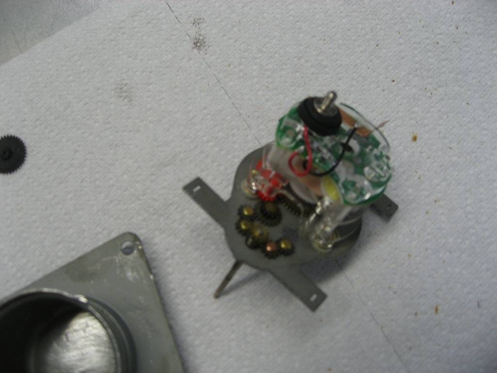

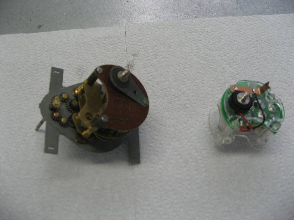

I replaced the guts on my '66 with a quartz kit. You'll find that the big three used mostly clocks made by Borg, so the kits are somewhat universal - the instruction video that came with mine was for a Corvette. Anyway, it hasn't skipped a beat in 2 years & keeps near perfect time.
