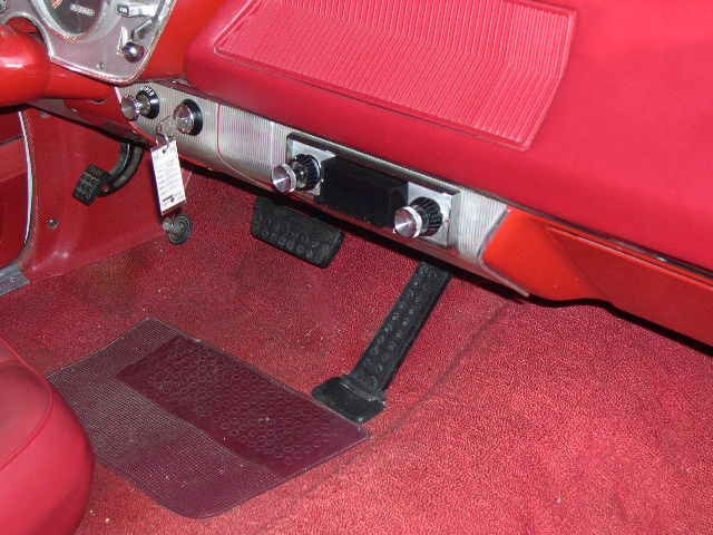

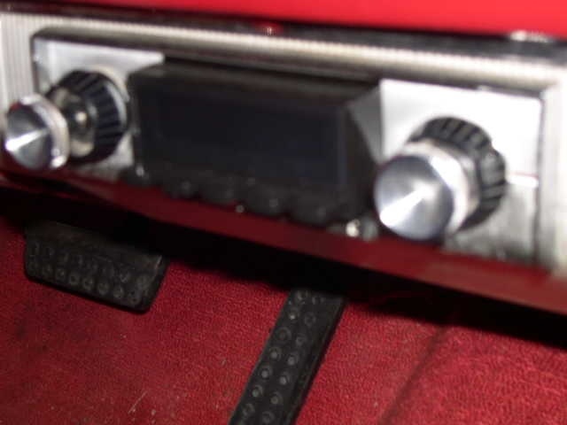

I just installed a Hermosa B stereo adding two speakers in the rear on my '63 Fury ragtop. Yeah a lot of finagling but the shaft-mount radio was the only reasonable option in my mind. With the earlier radio I put in I ended up doing some cutting in the dash; but not much that remained hidden by the face plate and would always be even if going back to an original radio. As well, I had a spare faceplate I cut out to accept the new radio having an original in storage again if ever deciding to have 100% original set up. Lets say I found this comforting before doing the fab work. The new radio needed some added customizing so a buddy who is a CNC op made me up an aluminum face plate insert. This avoided my plan B of cutting one out of plexi glass. My plan either way was to paint that part of the insert red to match the interior; but like the raw aluminum plate as is for now. The Hermosa has just a ton of features, more than I wanted having all sorts of plug-in wires. I made up a plexi glass plate to hide all this wiring but allowing the USB to hang down or slip over the plate. If I can send along a few pic's will do. I searched for a long time for a radio having features I wanted and offer a decent fit as shaft mounts aren't all that common anymore today..
here's a pics a bit grainy but quickly taken...
Another quick pic..
That looks really good for an aftermarket radio install.
I am very impressed with your dedication to making something look like factory even if it wasn't.
Thanks much Darthomas. Yeah as you know there are just a ton of possible ways to go enough to have me scratching my head for sometime. Having already done some modification years ago with the rad I had put in, decided to go this route and so far so good...works and sounds great...enough for my old ears. Coincidently I just had a new exhaust system installed and asked the installer for "mild" but also said make it sound like a Road Runner...he leaned more on the RR. A tad loud for me though sounds meaner than hell...just have to turn up the volume more!
