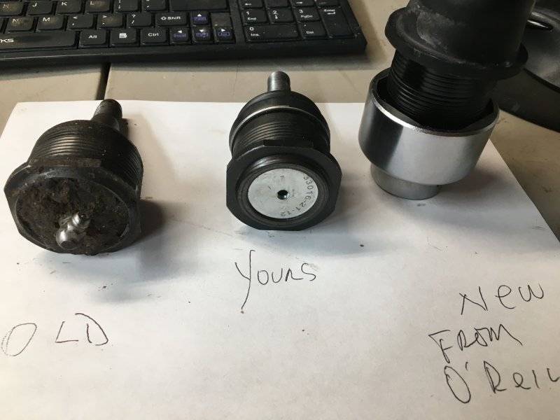

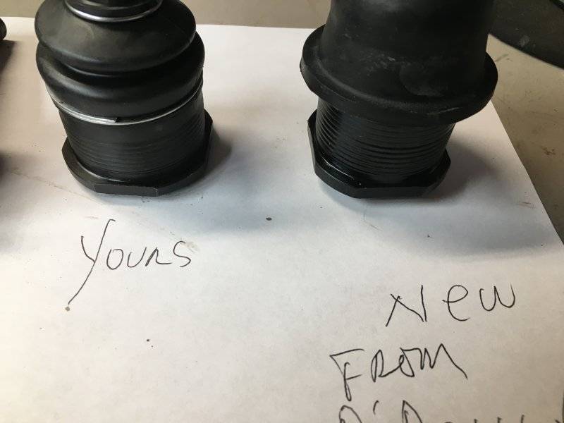

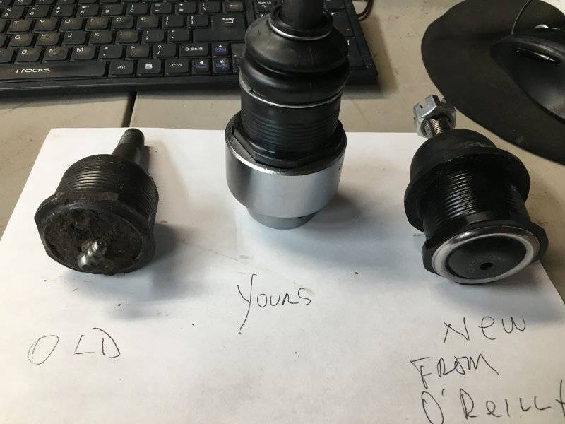

How do you screwup a ball joint? Well you reverse engineer it in China thats how. Same upper that has been used from like 62 to the mid 70s. I should know better. Pics are the OEM, China junk and O Reillys. Got a case opened with the Bay.

Just replaced my uppers with Moog balljoints. Passenger side went as expected. New ball joint went in tight but seated completely and torqued to 125ftlbs. Drivers side, the new ball joint went in too easy. When it bottomed out and I tried torquing it would break free and strip. Put the old one back in and it seated and torqued up fine. Repeated twice with the same result. The new joint had 5 threads while the old had 7. I didn’t pull the other new one to compare at that point but I believe the one new joint is defective…

Looks like it won't fit in the ball joint socket, looks too big.
