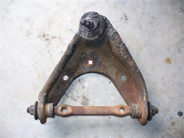

So ...... what's my next move here, I can't visualize how the threaded arm comes out as the widened areas where the bolts run through won't clear the bushings - I know this'll will be one of those "duh" moments , but ............ P1100020 (Small).JPG
.... and I'll be taking them in to have pressed out/in.
I always stick um in a big vise knock the nuts off and get an air chisel under the bushing flange and drive it out, remove the shaft and repeat with the other bushing. That 14.99 harbor freight air chisel will NOT do it, either.

As Rusty said get em in a big vise and get them nuts off then just burn out the rubber
Mine were so rusted I just got a nut splitter to get the nuts off without damaging the threads on the shafts then burn out the rubber, then press out the old shells.

OH! putting thes back together is a little more of a challange... First press one of the new bushings on then slide the bar thought the side the bushing is not yet installed then press the other bushing on.
!!!!!Do not press that second one on without supporting the A-arm or you will bend/warp it!!!!! I took a piece of 2" pipe and cut it lengthwise end to end and the same length to to fit and support between the flanges then safely pressed in the second bushing into the A-arm with the shaft in place.

air chisel like rusty says. to remove them then get a socket or pipe the size of the flange. open the vise just to use as a back up . get your pipe or socket and drive in the new bushing with a BFH.
I have a cup that was designed for a ball joint press that fits over the flange. use the vise as back up and put the air chisel up against the socket, cup , or pipe and rattle it in. I worked in a shop and we never used a press.

That's a great idea to section a pipe to support the integrity of the arm.
