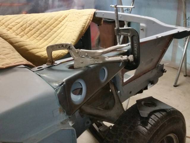

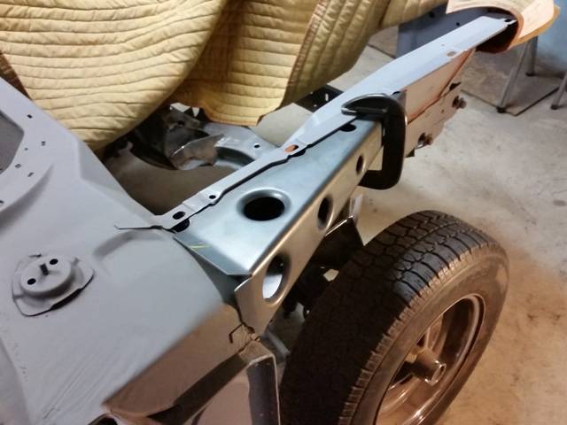

I bought the braces that US cartool has.
Much more beefier than stock.
Once the fenders are on, no one sees them.

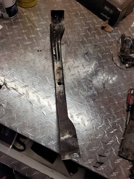

In addition to those, I also bought the lower rad support brace.
