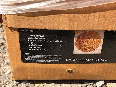

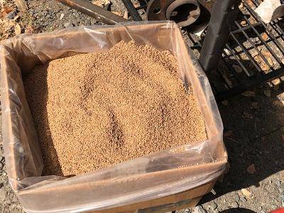

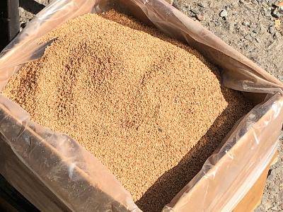

Walnut shells for blasting are normally ground into a semi fine powder.. Living in the valley when lots of walnuts a harvested & processed I'm guessing the guy came up with walnut shells that haven't be finished down to a useable point? Post a picture of what your working with....
The other possibility is moisture... Sand will clog due to moisture but walnut shells are more prone to it...
The sand was working great. So great, I was amazed that this is a Harbor Freight product!
I have a water trap that I can use but I'm thinking that the particle size of these shells is too big. There was no obvious moisture in the spray. Maybe the chunks got built up near the nozzle. When I unscrewed the hose from the tank, the shells sprayed out quite well from the tank itself but it is about 7/16" of an opening there.
I'll replace the hose and just use sand. I only used these shells because the sand ran out and because the shells were here to use.
Here is what the crushed walnut shells look like:
