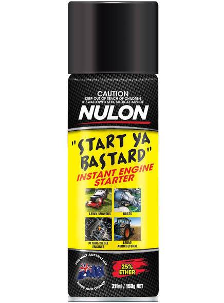

This works for me. It (almost) takes the cussing out of trying to start troublesome engines.
