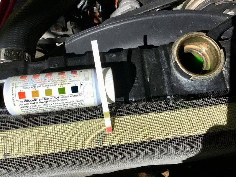

Thanks for the reminder. I think these colors are in-range.
