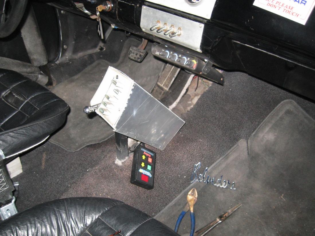

What shifter is in the car now??

Leave the stock mounts and bolt an aluminum plate to them and mount your shifter to that.
Or use the same plate and carpet it like the carpet in the car then mount your shifter on it.
Just a thought. I looks ok in my head LOL. But that's not saying much.

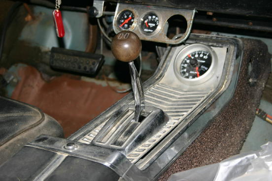

Hurst Pro-Matic in a '65 console
I like the Hurst shifter in the original console. Looks good.

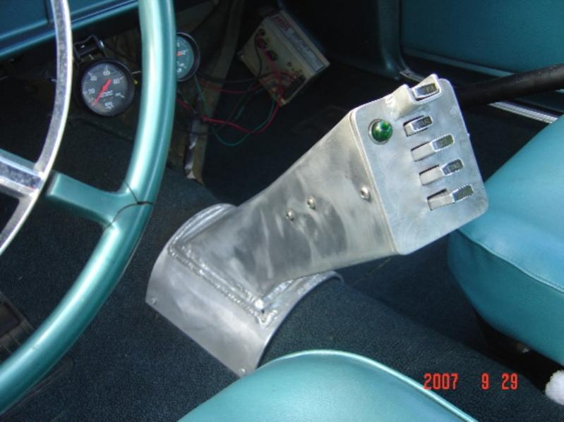

I would not be thrilled not having "park".You could just get a pushbutton shifter set up and mount/modify that so you can engage "park"
I mounted a PB shifter between the seats caus I am a righty:icon_wink:
