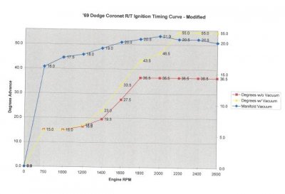

For a street driver, and even the occasional racer, definitely run the vac advance. I like to hook it to the ported port on the carb. This is the port that produces a vacuum signal just as you tip in (open the primaries) but nothing at idle and nothing at or near WOT.
Set the distributor up with a performance curve, meaning a little faster than stock, and have it all in at around 2500 RPM. Max advance for the basic MoPar V8 should not exceed 38 degrees. The vac advance should add about 8-10 degrees at the max ported vac signal, and that should equate to a light load "barely in the throttle" cruise.
