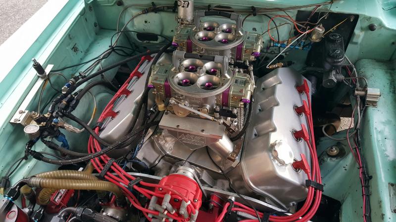

The electric ones aren't worth the effort. Just use a couple of -10 lines from your valve covers to a breather tank...that's all I have on my Indy headed wedge motor.
I run a GZ. Nice quality stuff. Don't know what it's worth power wise as I've never run w/o it. Motor makes enough to go 9.02@151/3350lbs.

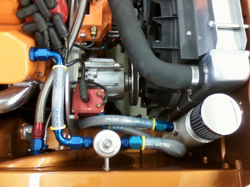

Star Machine is what I run on all my cars. I pull 11 inches of vacuum at idle. This is the Cadillac of Vacuum pumps.
I run their filter/canister also. I'm a dealer for Star if interested.
