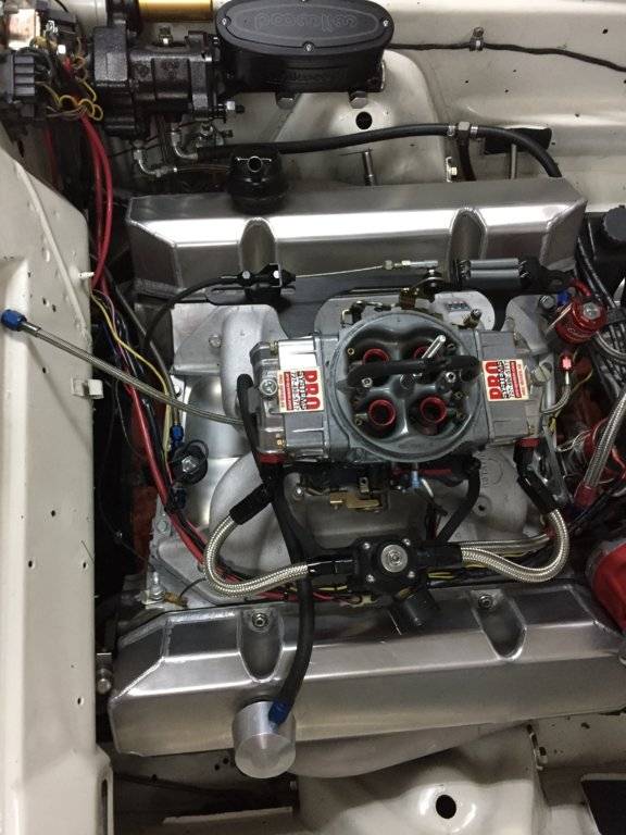

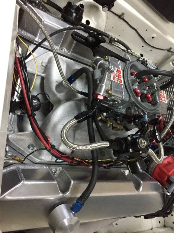

The nice thing about the GZ is that the vanes don't get gummed up. Mine pulls from the upper front side of the right valve cover. It'll go easy 25 passes and only pull about 1-2oz of oil. Great customer service as well.

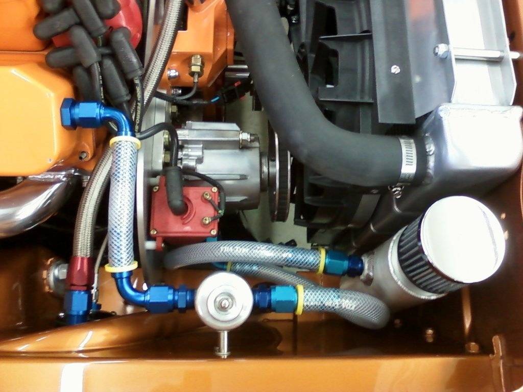

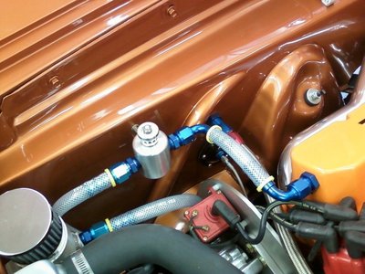

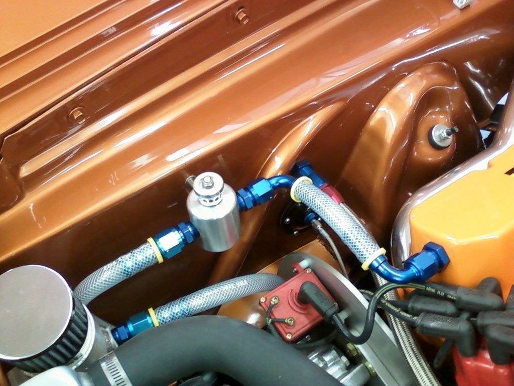

Man both of you Boys have spectacular Builds ! Also thank you for the pics absolutely Stunning !!!
Vacuum regulator . Kit comes with every thing. The only aditional part I ordered was the bolt on crank pulley to drive the alternator. I made a larger pulley later so I have that one left over. Excellent shape for sale.
