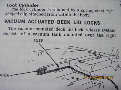

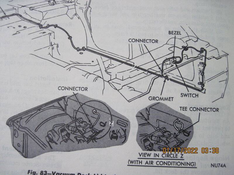

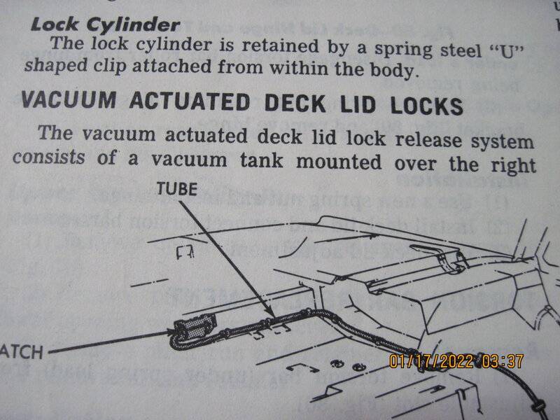

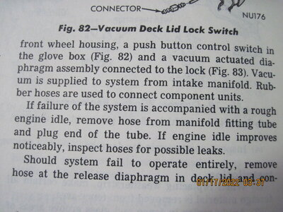

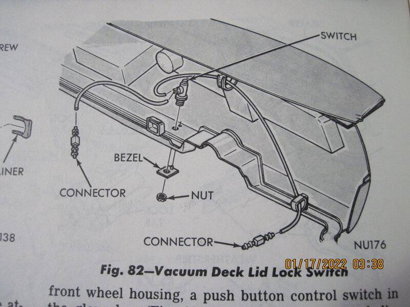

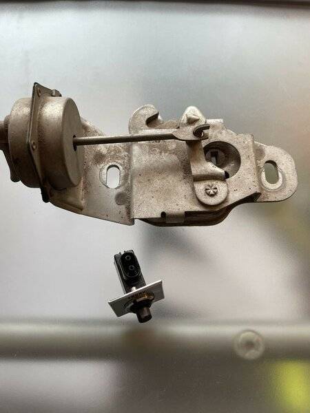

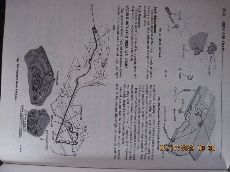

Does anyone have a diagram for the 1970 factory vacuum trunk latch. I'm looking to install one on my GTX. Can't find where to take the vacuum from for the latch.
