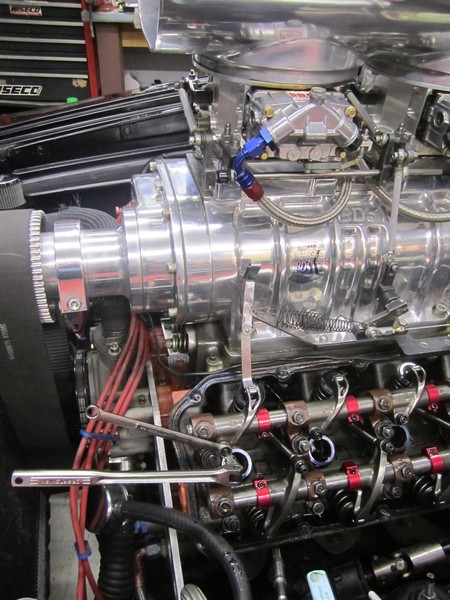

I dont want to highjack your thread but could I ask about doing the adjustments on an all aluminium world block? do the valves have to be adjusted hot only??
Any input would be of great help?
thank in advance!!!
With your engine,I would do it hot and then let it cool over night and see what they are cold. Now you know how to adjust cold
Somewhere I read that the rule of thumb is aluminum heads and steel block subtract.004 from the cam card. Aluminum block and aluminum heads subtract .006 from the cam card.
You really should set them hot then check them cold.
I just did ours tonight, be it known the heads were only 115 deg. there was only .003 difference. I'm sure at 180. they would be .004
