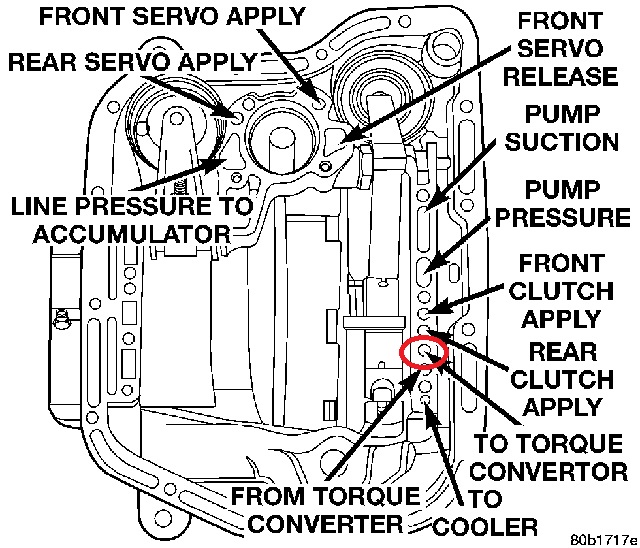

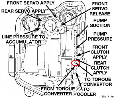

most, new, manual valve bodies cannot be reversed back into OE configuration. Fine an OEM valve body and you can put it into place. Now, some kits had the (see pic below) trans housing modified with a small plug. Be sure this is not located in this port, if it is, remove it prior to installing your OE VB.
