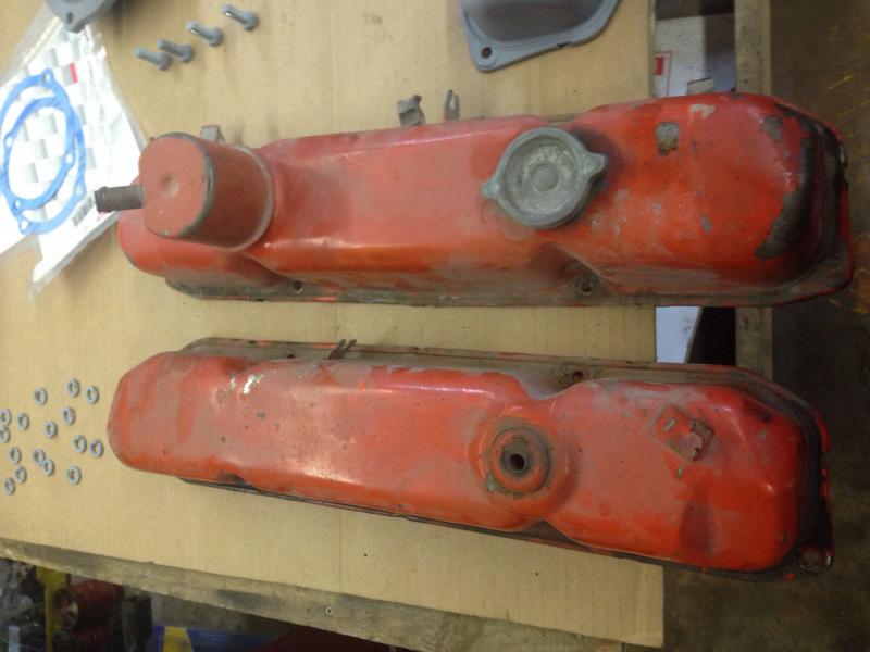

I tried twisting, pulling, and prying on the breather cap for my big block valve covers and cant get the thing out. It just spins.. Behind the valve cover is a baffle so i cant really see how its in there. Were these meant to be removed. Thanks. I post a pic of the style i have. Valve covers are at the shop image.jpg
They pop out. Pull & twist usually does it.
Chuck
How old is the rubber grommet that it fits into? If it's several years old, it's most likely dried and hard as a rock and if it's original, it is dried and hard. Heat might/should help to get it out. Heat lamp or hair dryer should do it.
image.jpg Can anyone help identify the year of these valve covers. One of the corners is slightly indented. Thanks
Did some research, they are from 1971
