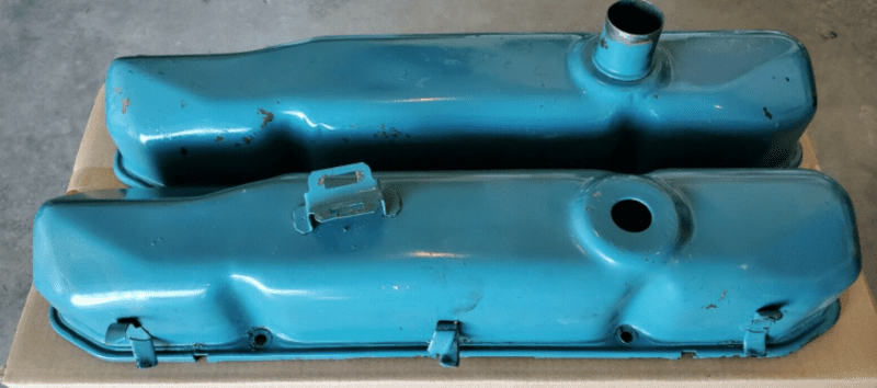

Looking to see what others recommend for an OE set of covers on a 68 383 Charger.
I'm going with the OE style with the tabs

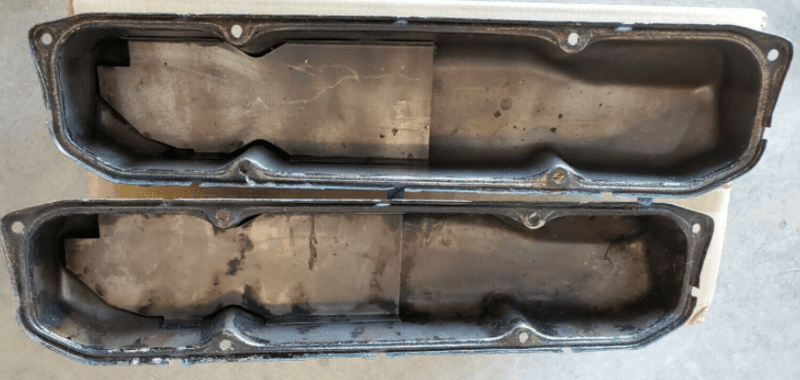

Thanks everyone. These are my covers
Jmho Rebel, I would use napa or felpro cork making sure your flanges are good and bolt holes not pulled.

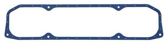

Edelbrock makes a set with tabs also
https://www.edelbrock.com/valve-cover-gasket-set-for-chrysler-7591.html
I run the old Fel Pro rubber gaskets with tabs that where made many moons ago and are no longer sold - I cleaned out Rockauto when they went on clearance years ago

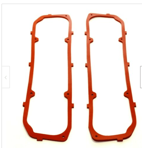

Those real gaskets look pretty nice also
