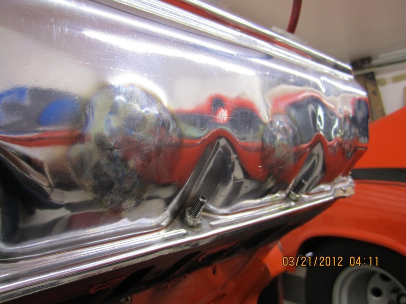

Get a name brand stud that has the allen head in the end to tighten the stud.
