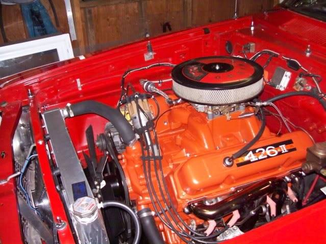

These are Eddy chrome valve covers that are higher then stock but look close to stock. Thats why I used them as I wanted to have the Max Wedge look. I just painted them with the Hemi orange and they turned out good. I use Hughes roller rockers and they clear with room to spare and my cam is .634 lift. Ron
