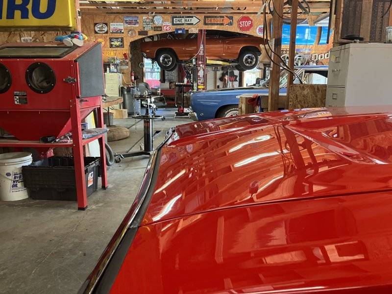

I used to think that I wanted that clackity clack sound of a solid lifter cam for my Charger. I have adjustable rocker arms so I went with a Lunati solid, then a Mopar Performance 528. Both ran well but the 528 went flat last year. I pulled the engine to rebuild it and put the Lunati back in.
I've grown tired of the clackity sound. It isn't obnoxious but it can be annoying.
Recently a buddy asked for my help with his 68 Plymouth so I brought it here to do some work. It has a mild hydraulic flat tappet that makes absolutely no valvetrain noise at all. Another pal with a 69 Coronet also has a hydraulic flat tappet that also sounds quiet. It has me thinking that I want to switch back to something hydraulic to cut down on the clatter. Both of those cars make plenty of power and their engines sound great. The blue Plymouth turned a 12.80 with the 451 and 3.55 gears so it isn't slow.
