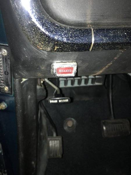

2. I am trying to put the bulb into my BRAKE light indicator on the dash but can not get my fingers under the dash to install it. Does the indicator pop out of the dash so I can re-install the bulb and holder? Also, the light does not illuminate when the emergency brake is engaged. I tested the bulb and it is good.

2. The 67 Coronet brake light is in the cluster, unlike the 67 Belvedere. If you cannot get to it, you may have to pull the cluster. Refer to the service manual.

This is what I am talking about. Is this for when the emergency brake is engaged?

So, is this suppose to illuminate when I engage the emergency brake? and is it easily removable to reinstall the light bulb?

Sorry you are correct, that is the brake light on your car. Yes, depressing the emergency brake should light it. It should come on steady for several seconds, and then start flashing. It's a special bulb, and sort of hard to find these days. Also it's the same number as the more common bulb that doesn't flash. #63 comes to mind, but I haven't referred to the service manual. It may have a dash and another number or letter designation.

So does this pop out of the dash so that i can install the bulb? Or do I have to pull the dash apart?
