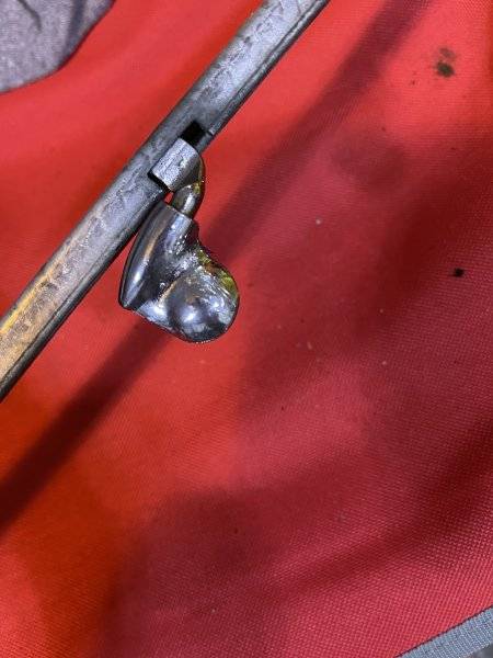

How do I get this off?
Does it appear to be welded in place, crimped, screwed from the other side?
The part that has the screw hole for the window should slide off the pin. Then the pin is riveted to the frame. My 67 B body was this way. Fairly sure my 69 Dart was that way too.
